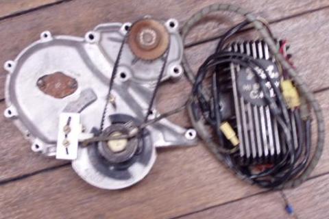

Well well well,
Looks like a case of hands on vs text book once again.
This cam will fit any nissan A series and it will happily control valve timing acurately allday long. Like I wrote before, If you plan to run the stock dissy in the stock location in an A14 or any A series 74 and up - this cam wont work. Any other method of crank angle sensing will happily work with this cam.
Below are 2 examples;
Below is a Nismo Ultra setup. If Nismo can run the ignition of an A series without a pickup in a dissy, I think anyone can if they use their brain.
So basically the below post is bullcrap if it continues to contain the word ONLY.
These will fit & work in A10 & 1200 engines only. [up to '73]
