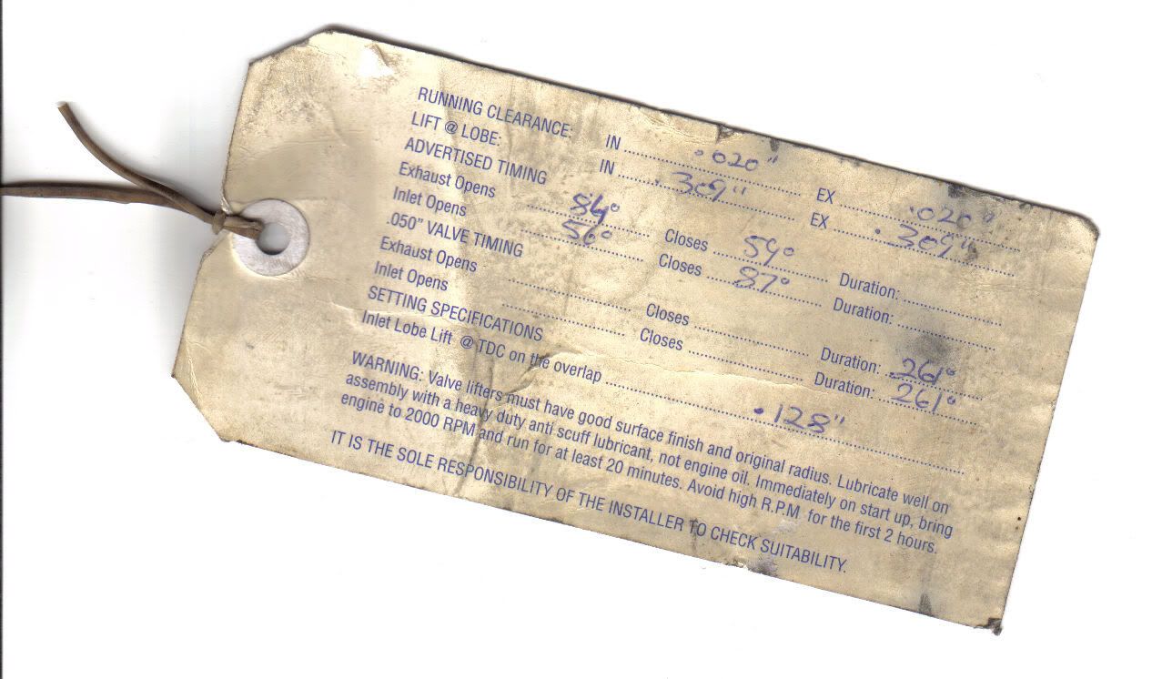

A15 40 thou over
#### Mazda pistons with about 9.5:1 comp(what are you using to get your 11:1 ?)
Balanced everything...... light steel flywheel
This cam with 1.65:1 roller rockers
Small port oval head....... not hogged out..... I wanted airspeed not volume 38mm inets 33mm exhausts
Twin 40 webers (soon to be efi with 50mm quads)
Mech advance electrinic dizzy
More specs here Mostly wrong though as car now has different cam and pistons
Dyno sheet (recorded at wheels)
Car will get another 40 thou overbore and better pistons to bring comp up to around 11.5-12:1 soon
Will also get the efi system and we will be running some tastier fuel
I'm hopeful for closer to 150hp atw.
