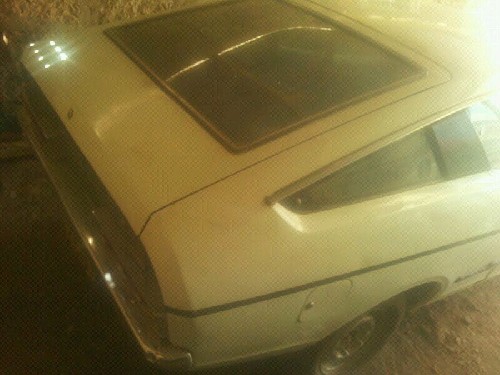

Im new to the forum but not new to Datsun...my grandpap had a red datsun 120y station wagon and it was really simple...gear, steer, brake. I learnt how to drive in it. Now many years later I want to get a coupe version and have come across one for sale in a farm far away. Owner claims its been sitting for the last 2 years and the body looks preety good. What should I look out for before I purchase? I want to spray it Ferrari Red and put in some nice rims. Please advise. Posting pics shortly.

Look out for rust. Lift up the carpets and inspect.
#533 Re: B210/120Y Dedicated thread
L18_B110 Posted on: 2013/3/1 20:07
the coupes have problems with water sealing around the top of the rear hatch. They can rust anywhere around there - under the hoodlining just in front of the hatch, under the base of the rear seat etc. Also tend to rust around the brackets for the fuel tank - normally on the left side of the car. Pretty easy to see underneath. As well as the usual Datsun spots; cowl - back corners of engine bay and under the dash, under the battery tray, under the master cyl, gaurds behind the wheels, floors, sills, spare tyre area...

Hey guys. I have just posted pics of my intended buy. As you can see the engine is in a preety awful state but i want to maintain this original engine. Please advise on the following:
1. IS IT A GOOD BUY
2. WHAT'S THE FIRST THING I SHOULD DO TO GET THE ENGINE RUNNING AGAIN
3. WHAT SEQUENCE OF REFURBISHMENT SHOULD I FOLLOW? ENGINE FIRST OR BODY WORK FIRST?
I will certainly appreciate your assistance. Thanks.

Looks like it needs no bodywork. Engine looks OK. Just fire it up and drive it. It would be a good buy for $1000 if it drives well.
I would fix the interior.

robbie Posted on: 2013/3/3 19:45
Thanks ddgonzal. I want to paint it ferrari red and also fix the interior. sorry for the not so good photos. So what is advisable to do first? The interior or the painting?
