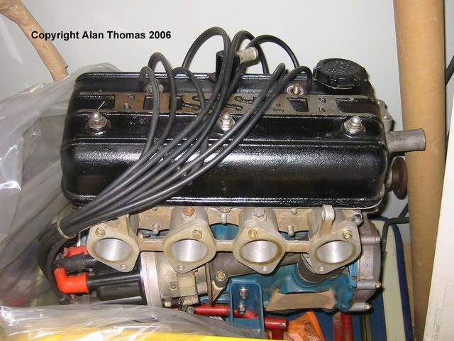

I'm quite sure that the other four spark wires go to special ignition coil.. or the angle drive droppes the ratio to half from normal distributor speed, 1/4 crank that is. Can take more rev's maybe?
Or somekind of mechanical twinspark?
The angle drive of distributor is not in the homologation of PE10 so you can follow the rules of the year 1975 FIA book.

While nobody seems to have noticed it, four of the plug leads seem to terminate directly into the top of the rocker cover.

This one too seems to have four plug leads terminating into the top of the rocker cover.
There has to be a reason for it. It's not a distributor that was sourced from a V8 engine is it?
A study of these two pictures would seem to confirm that there is only a single plug in each cylinder.
