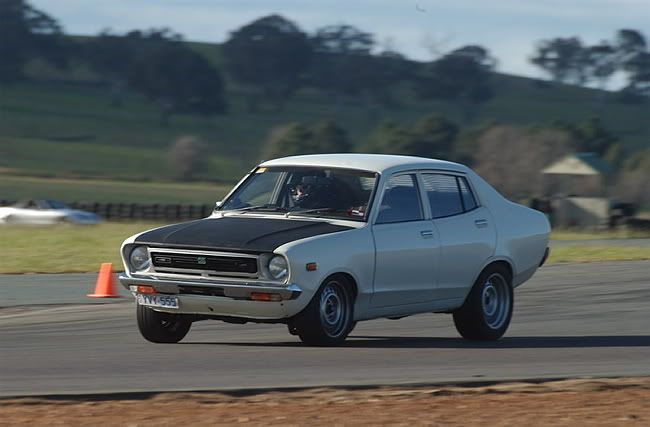

Tyrie, this is my car at the same corner at Wakefeild about 5 years ago.
#19 Re: rear sway bar.
benny Posted on: 2007/7/18 6:11
I run koni sports up front with 275 lbs kings. No rear bar
#20 Re: rear sway bar.
PIGDOG Posted on: 2007/7/18 6:12
hahahahaha just sitting a bit flatter
