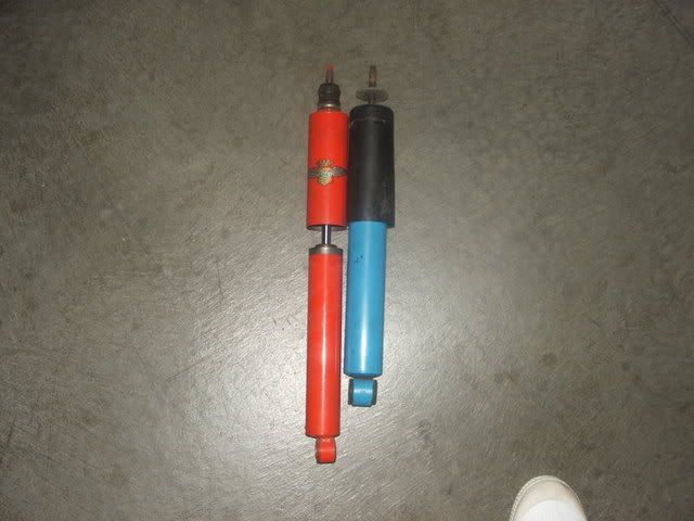

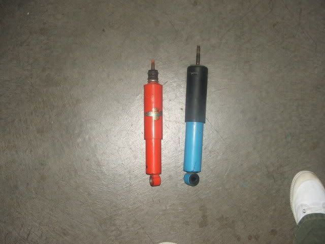

Compressed and uncompressed comparison with Datsun Coupe Competition Shock. The SAAB shock uncompressed about 40mm before I could take pic so I'd say they are oil/gas assist unlike the konis. They are about as firm as the konis are on mid setting.
SAAB 900 Front Shock 360 Uncompressed / 275 Compressed
Koni 1200 Coupe Comp 430 Uncompressed / 270 Compressed
I measured without rubbers on top so would have to add say 10mm to compressed figure.
