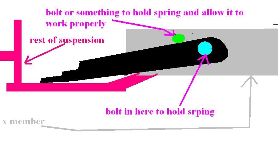

doubt you could go drop the x member would mess everything cause of how that damn leaf spring is setup it would give less traveli guess? hmmm i wonder if you could cut the spring and have a setup so it 2 different springs and a section in the middle off the x memebr where there are no springs does anyone get what im saying?
[edit] here a hlaf off wat i was talkin about hopefully it help people understand
Hopefully, this will help you with your explanation.
The spring is not retained by a bolt as you can clearly see in this illustration.

He was suggesting cutting the factory spring so that the crossmember could be modified to sit the motor lower. Then somehow bolting what was left of the spring on either side.
I'd say it'd be easier to ditch the spring and build some coilovers if you wanted to modify the crossmember.

Durrrr. OK, got it now, .... thanks.
