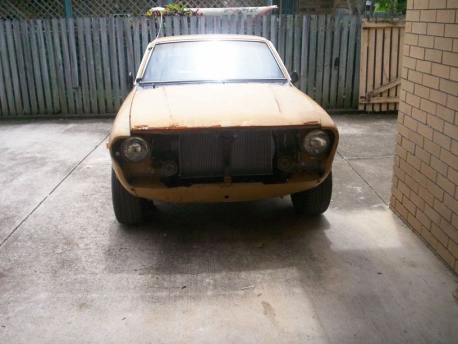

I purchased this off a member several years ago,cant remember who?? Istarted it in december 07 and is now ready for registration.
It is now my sons drive car, come track carOpen in new window

Fitted 200b struts and brakes
Slightly worked 1200 motor
13x6 steel wheels.
It will be registed as a 2 seater.

1200GXman Posted on: 2008/4/23 8:33
Sure has a big radiator.What radiator is that?
Some engine bay pictures would also be nice when finished.

vixen Posted on: 2008/4/23 10:34
The radiator is a hyundai excel they fit quite easy and only $90 aus new.
Most of the components on the car have either been fixed or replaced if nec.
The motor is fully rebuilt with oval port head extractors 32/36 downdraught weber.mild cam and small amount of head work.STD bore a1400 crank with top of pistons machined flat=10.5:1 comp.
The paint colour is windsor blue(1986 Jag).
