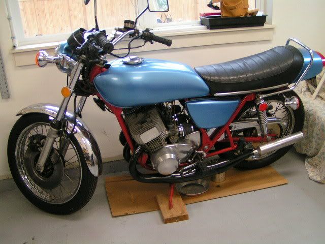

heres my 2 stroke, 75 H1, needs a clutch cable & an oil leak resolved & a final carb jetting otherwise runs good! (besidesd a hideous 20 year old color scheme I chose back then )
