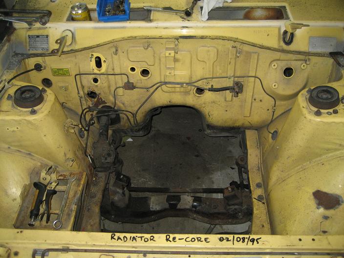

well i thought i might make a thread for my latest ute.

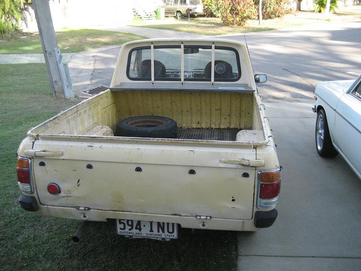

heres a few pics from the start before any work started

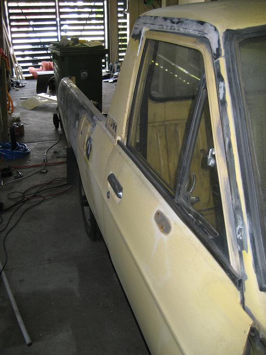

the next step was to cut start on the tray lip so out came the angle grinder for some fun

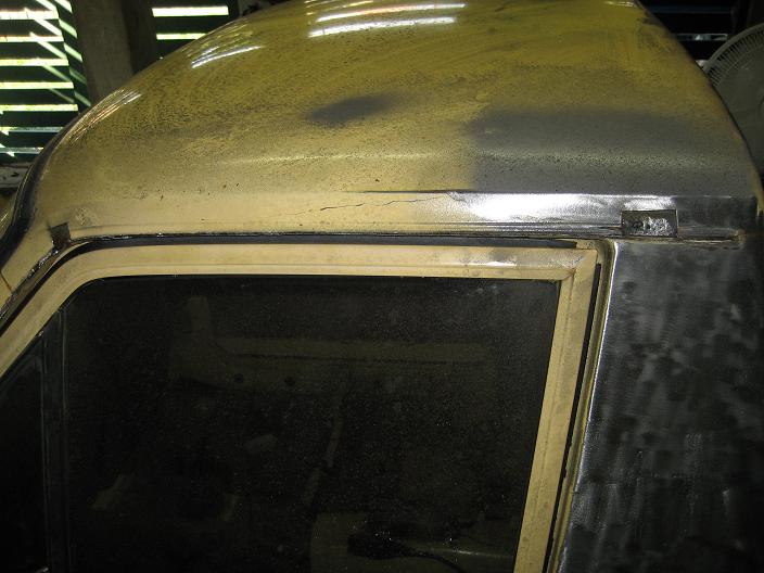

and then the rain gutters aswell plus a small amount of fill after all the panels were welded, to reduce warping it was welded in sections of about 20cm.
whilst the gutters were removed some rust patchs were replaced with new metal
the side panel was replaced as it had too much rust

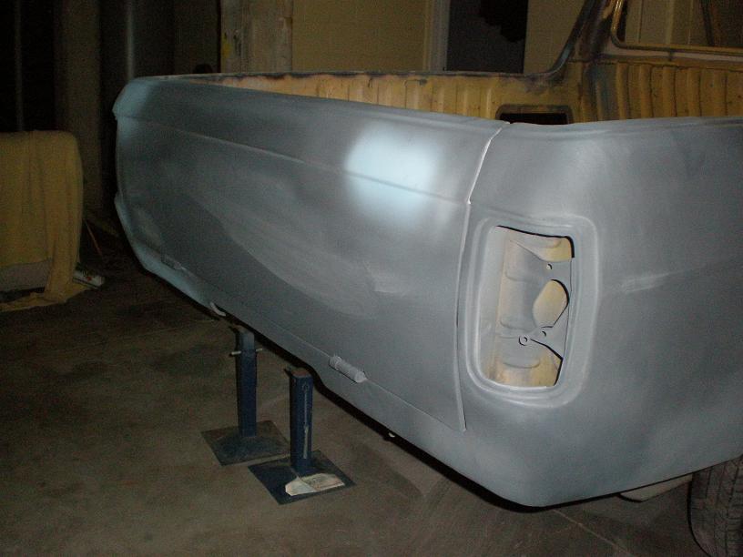

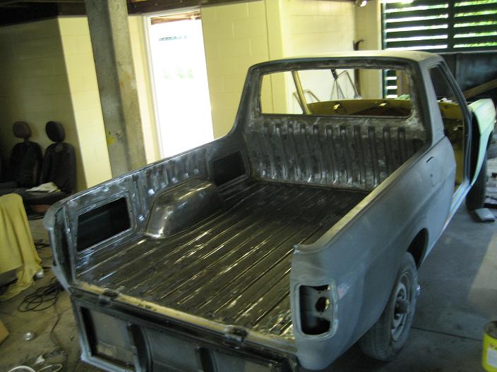

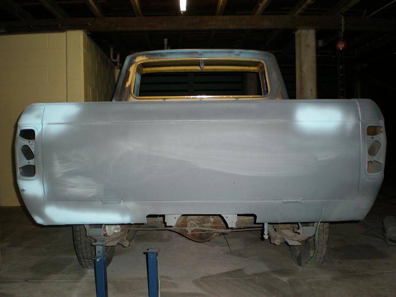

the bumpers were removed and welded along with the tray then being stripped and most of the dents fix as much as possible
before the tray was done the tailgate had its handles removed and welded new metal in
the rear quarter that wasnt replaced was smoothed out over and over again until i was happy

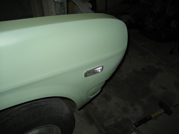

the color ascot green was chosen but now wont be the color as im going with the new ford gunmetal grey color.
the side indicators were adjusted to fit honda civic indicators

There are droplets of liquid in the shot with the civic lights on the bare-metal guard. What is it?
Are you using a liquid to cool the steel as you weld to stop warping?

hey chris its actually fish oil so it doesnt rust up
