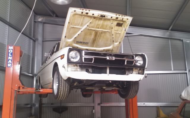

Scott from MADDAT is putting some finishing touches on things i have started but not completed and general tidying up of the mechanicals I have not touched yet.

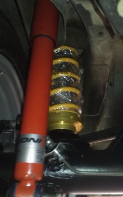

The rear end is basically set up now with all hard & flexi brake lines completed. New Koni Shocks in. The springs are 200mm, waiting on some 150mm so we can have some more play on the finished product. Looks the goods :)

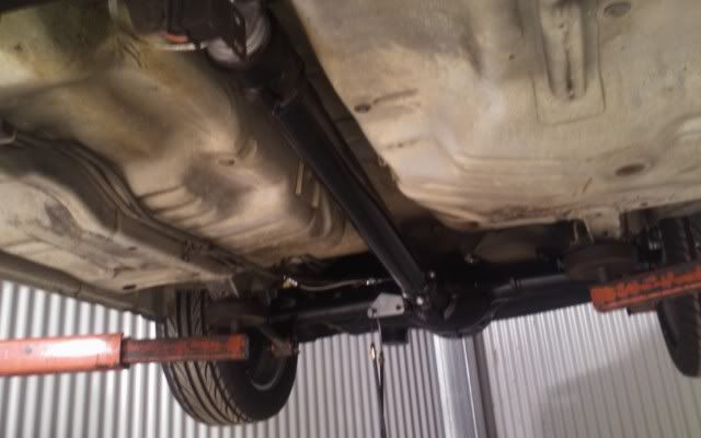

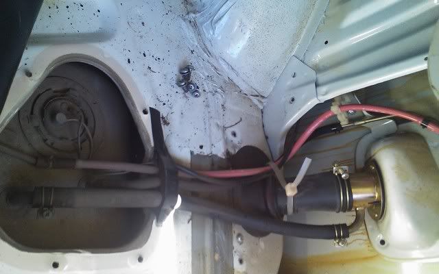

New 8mm fuel line is run in and you can also see the tailshaft is complete and fitted. The hand brake has to be relocated so is not finished yet. Good ol' Sunny had room in the brackets to fit the extra line so all looks standard!

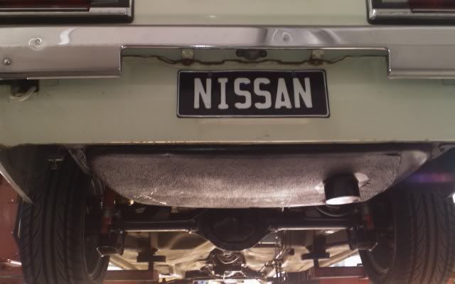

Also the fuel tank is complete and fitted. All pipes fitted in the standard sunny set-up with the connections accessible from the boot. So no give aways if i'm putting the shopping in the boot. Slight give away is the small drop in the tank on the RHS to fit the pump and pick up, only to the keen observer..

Only minor update is that on the Wednesday just gone, I had the Sunny picked up and she's now sitting in the maddat workshop.
One issue we had was that there were no springs with the correct rate and size, height etc. that would suit and manufacturers wouldn't guarantee if made, they would be the right height. So have ended up going an adjustable coil over type set up (shocks in original spot). This is a bit beyond me so Scott is setting it up and finishing off the brake lines on the diff.

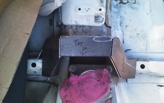

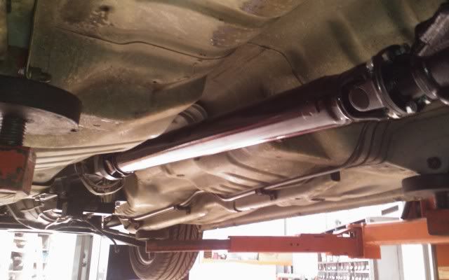

Hi guys. Haven't updated in a little while. To be honest I haven't achieved as much as I would have liked. At the moment work doesn't leave much time for the datto. I've been doing little bits here & there like cleaning up some wiring and finishing cutting some bits for the reinforcing of the drive tunnel as below.
I have also removed the fuel tank as i am hoping to get an in tank pump set up in there. I have dropped it to Scott @ Maddat as he knows a guy that will do the welding. Its an odd shape as the spare is above it, but due to the pipes being accessible from above should be easy enough to hook up (hopefully).
At this stage I am looking at sending the Sunny up to Scott to sort out some things to speed this project up. Like finishing a few bits on the diff and tailshaft. Just things that will take me forever to do at home with the lack of tools & space. I really want the Sunny on the road this year, it's killing me driving the work car everywhere! My thoughts are when it comes back there will still be work for me to do, but less fabrication as its out of my depth & my welding skills are not up to scratch.

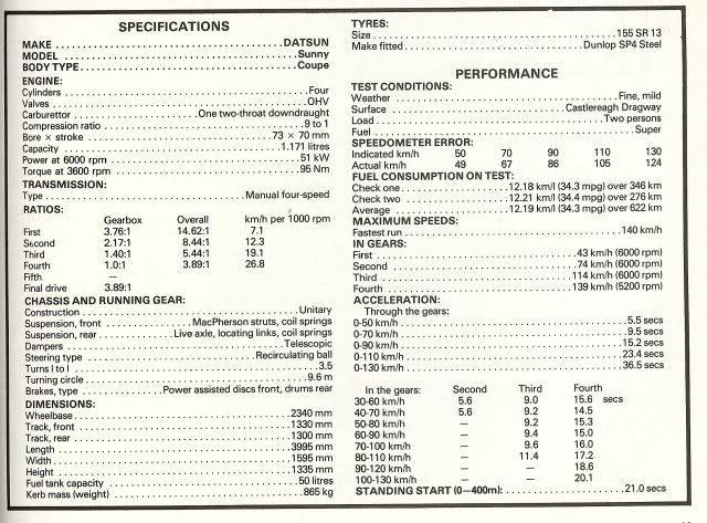

For a bit history, a while ago a bought a wheels magazine from from 1979 off ebay. Here's the specs from their test, including the 21sec 1/4 mile :)
