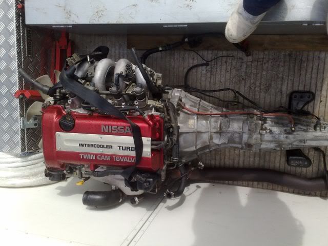

Another minor update:
Engine now sitting at the oldies, where the bulk of the work will take place (cheers dad!).
I purchased it from Anthony at Grand Auto who has helped me out with parts since I started driving basically! It came out of a 180sx with a readout of 180kw at the rears. Apparently it has had a remap and a roller bearing turbo installed.
Plug: Grand Auto Wreckers
Anthony also has put me on to another engineer (2 months chasing a certain engineer, and not 1 call back is a little frustrating!!), and things are starting to happen. The car is going in Friday to have the once over on the hoist, and then things will get underway with all the legalites.
Will update after tomorrow, but not much else will happen until i get back from holidays late September.
