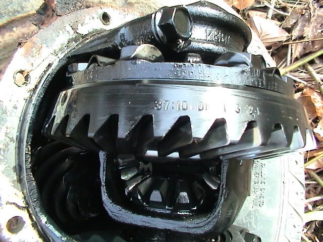

In the never ending search for more mpg's I am searching for a 3.54 final drive for my B210. Most 210's and B210's had 3.70's [like mine] or if equipped with an auto trans, 3.90's. OK, so my factory shop manual says that a the 3.54's were available in the 1980 210 with 1.5 liter engine and a five speed. That certainly narrows the opportunities to find one. So I know where there is an '81 210 with that driveline in an old junkyard up in the woods. Here it is.
This place is up on a mountain and you can only get in there by foot. It isn't fun to carry everything you need for a job like this up that hill. But I am serious about improving mpg's so I rise to the occasion.
Pulling the axles......
I brought a come-a-long and other paraphernalia to get it done.
Doh! It's not a 3.54 but a garden variety 3.70 diff. My book said the 1980 cars had the 3.54, but this is an '81. I don't have a manual for the '81's. I thought they'd be the same? Anyone know what final drive an '81 [US] A15 5-speed car is supposed to have?

In Australia, the five speed & auto versions of the series one & two P910 [Bluebird] came with a 3.9 to1 diff ratio, but the four speed base model had a 3.7 to 1 ratio.
Five speed = overdrive output ratio with lower ratio diff.
Four speed = direct drive output ratio with higher diff ratio.
I have always assumed it was done this way so that the final drive ratio in the highest gear worked out pretty much the same for both.
I would suggest that the same applies to the US model 210 [B310]
There should be a build plate on the firewall with the ratio of the diff that was fitted at the factory.
The last line of vehicle build info is marked 'Trans. Axle.' & will show the trans model as something like F4W60L then followed by something like HB37
The code for the H150 differential is HA & the 'new improved' H150A differential is HB. The number is the ratio 'code' & 37 is for 3.7 to 1.
The 3.54 to 1 ratio that you seek will probably be shown as 35.
I suspect that you will be looking for a US model 210, coded as either HB310 or PB310 with a F4W60L & a HB35.
[H= A14 engine & P= A15 engine in these B310 models]

Thanks very much Dodgeman. What you are suggesting makes perfect sense, and now I can use the code on the firewall tag to know what's in the car before I remove the diff. But I am not aware that Datsun ever mated a four speed with the A15 in the US. I'm pretty sure only the A14's had the four speeds. The '80 factory manual clearly states that A15 powered five speed cars were the only ones that used a 3.54 diff. What I am hoping to find out is if someone with an '81 manual could go to the PD [propeller shaft and drive line] section and see what the specs are for 1981. Perhaps the 3.54 ratio was only used for one year in the USA?

I have the 1981 manual, but it is Australian specific & all of the Aussie spec passenger models that were sold here [Four Door Sedan & Coupe] were A12 powered with F4W56A trans & [nominal] 3.9 to 1 diff ratio. [HA38 for 3.888888 to 1,]
The vast majority of the Sportswagons [which are regarded as a commercial vehicle] came with an A14, plus F4W60L & HA38. These were model coded as WHB310's
The last of them here came with the A15 & 60 series but with the HB37 coded differential. These were model code WPB310 vehicles.
In short, we never got the 3.54 to 1 diff.
