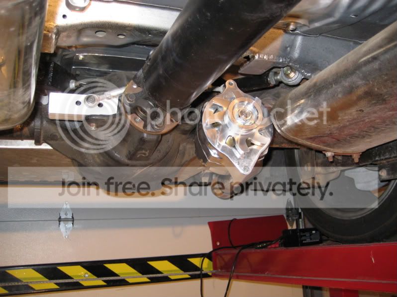

On the Alternator subject, it is somewhat common in racecars to run the Alternator under the car, driven off the pinion [via a belt] of the differential. Maybe this is something you could look into.
I lifted this pic off the web, so that you get the idea.
cheers
