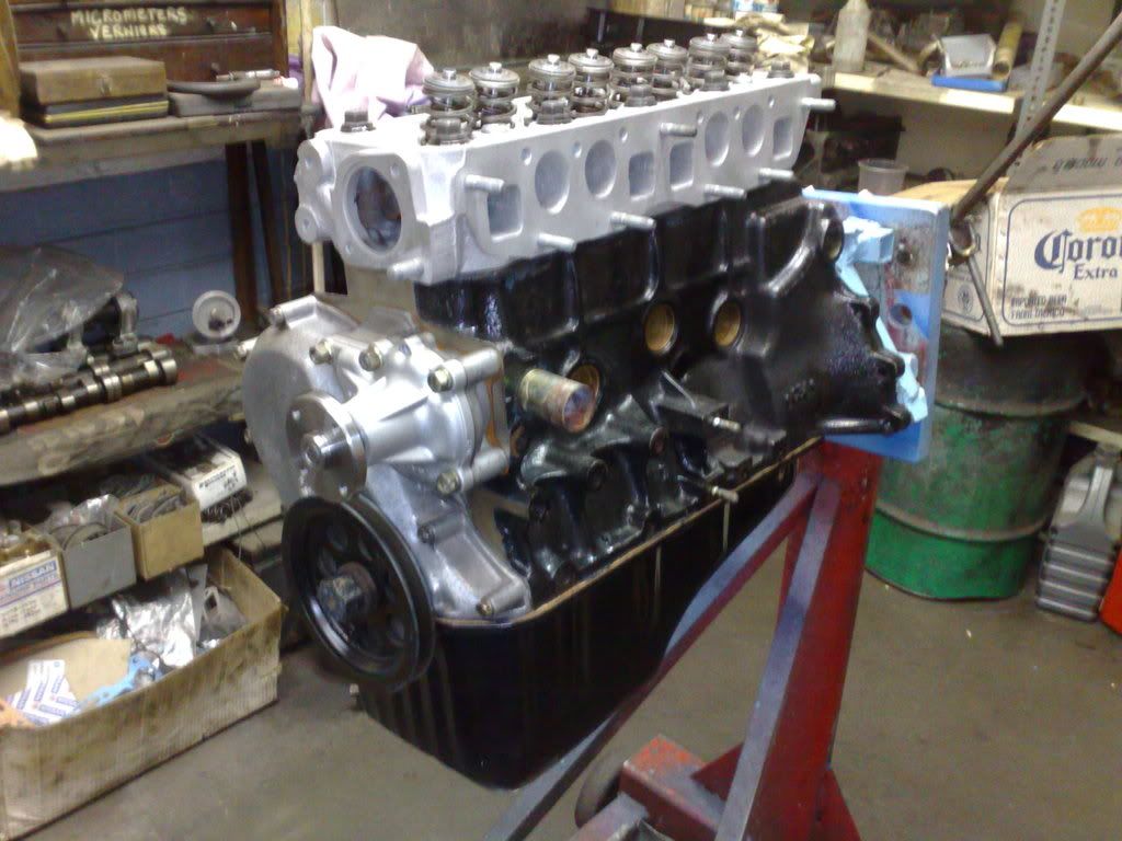

My Reco'd bottom,
My Reco'd Head

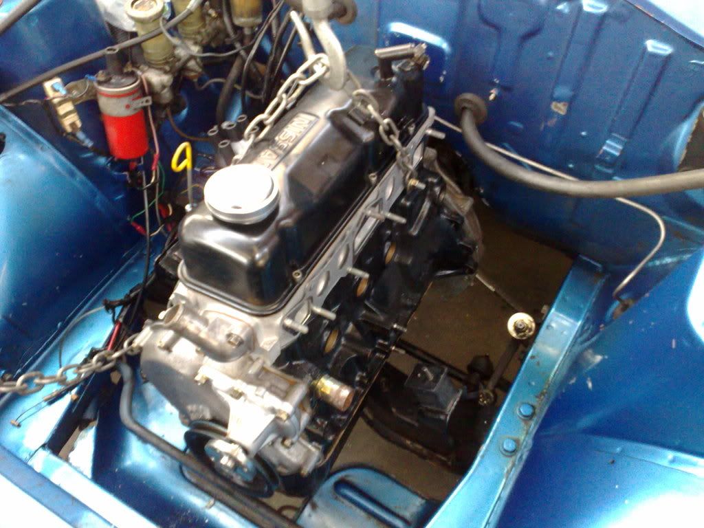

All together now!
Posted on: 2008/9/23 10:53

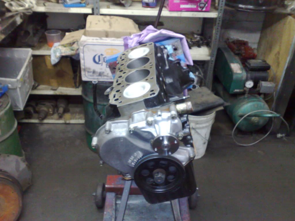

Go'n in..........
Posted on: 2008/9/23 10:55

is this the a15 you got off crispee? what kind of nick was it in before you rebuilt it? i supposedly had 30,000kms on it
Posted on: 2008/9/23 12:37

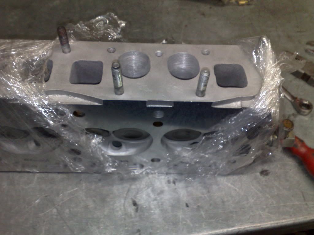

Is crispee "D" ?, Nah Its not that a15, I got that one to use whil's this one got rebuilt.
This one is Bord 1mm, Cam, portmatch, closed chameber's...

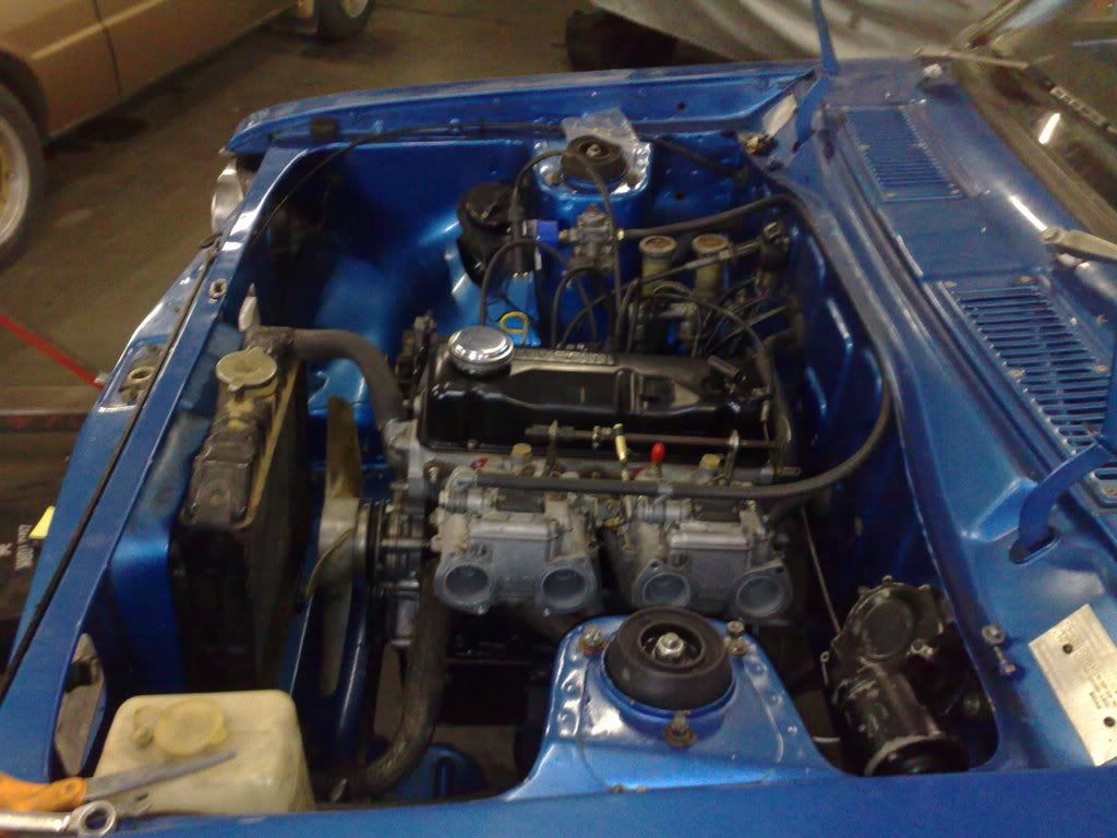

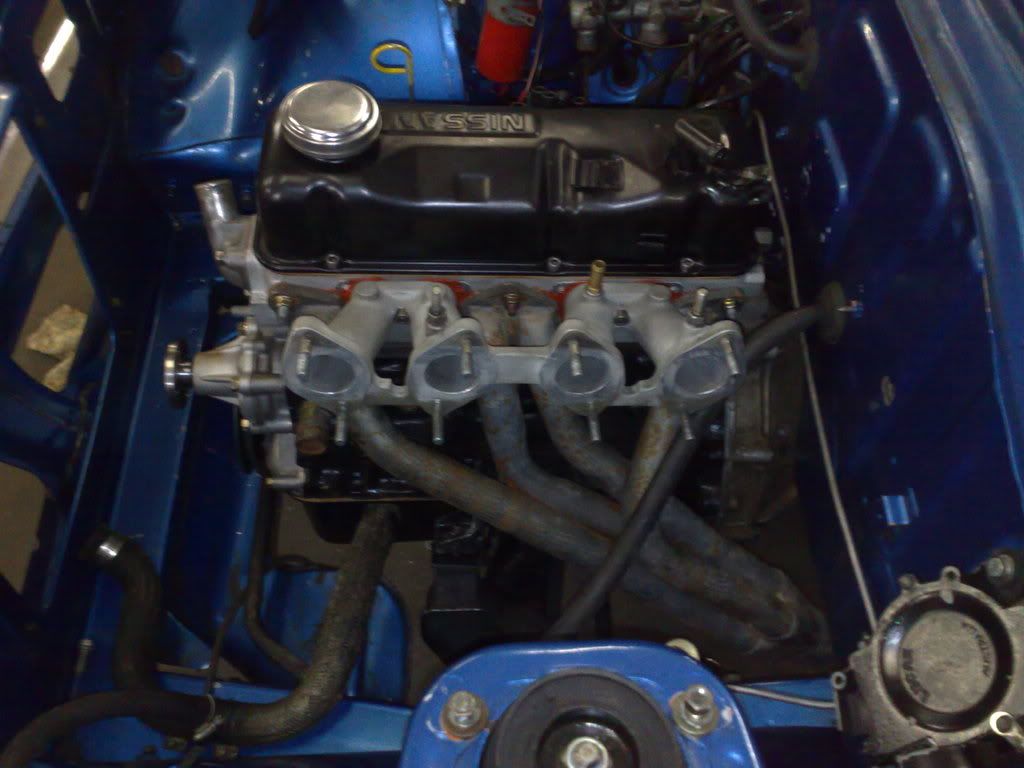

This engine will boogie.
So what make carburettors are you using?
What do you mean by closed chambers? Are the compression chambers filled in a little or something?
Did they port the exhausts as well? They look a little bigger than what I'm used to seeing, or maybe it's because everything is so clean....

Nah stock exhaus port's.
I am useing 40mm dellortos.
And to my knowledge (witch is verry questionable)
there are..
*The closed chambers wich are the small kidney shaped ones
*oppen chambers, with are round (much bigger volume/lower compression)
Posted on: 2008/9/24 8:35
