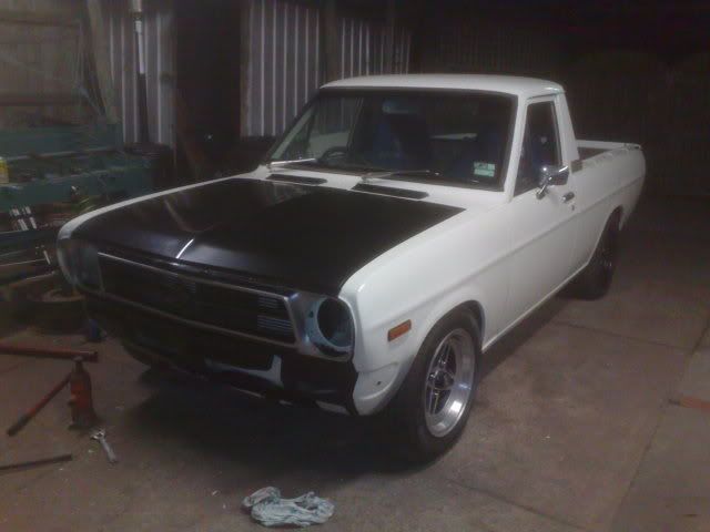

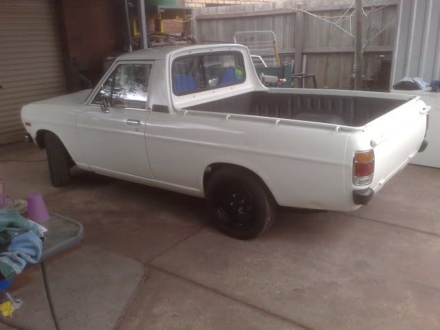

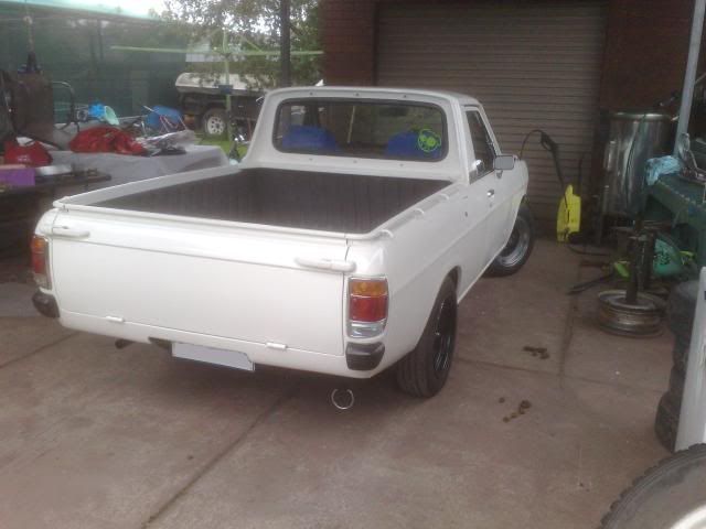

well its been a while, but ive had the ute on the road for about 2 months now, ive mostly been driving the bajebus out of this thing , ive aready put 6000k's on the clock. she seems to take all i can give it and still wants more!!!

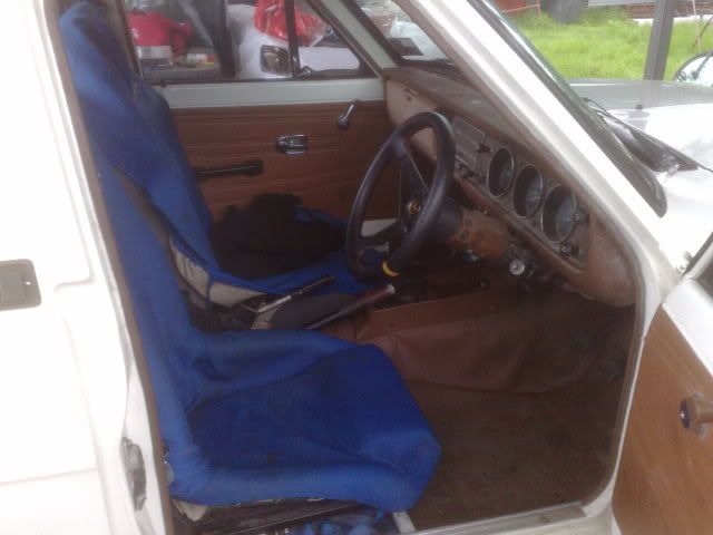

curently im getting back into drifting agian so she's kinda becoming a skid pig.. its strange how well these slide with little to no mods, so far ive been just modding it slowly, just tweeking things as i see fit, so far ive put in to it a hydro hand brake, locker, rear swaybar, 120y front swaybar, semi deep dish steering wheel and modded an old saas fixed back seat.ATM im collecting all the parts i need to convert to a L18...

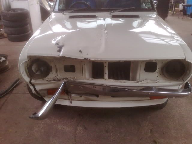

things have kinda gone backward in the last couple of days, to cut a long story short, i crashed into my gate post in my driveway!! the damage isnt that bad, as of today i pulled it all strait and under coated it all, the other day i bought a new grill (the old one was nacked anyway, so no loss there), new bonnet and new apron. as you can see the bumper is stuffed, but that too wasnt in the best shape, so no loss again. oh and the dint in the rear quarter was from the same crash... some how the rear landed on a milk crate of all things

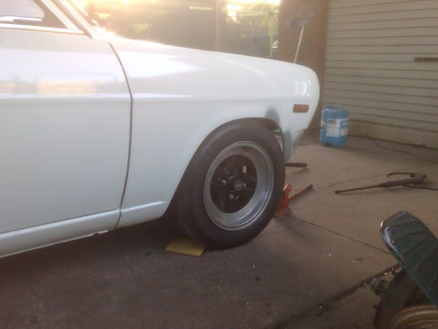

yeah still on the hunt for a 4th enkei colin cross fever... every now and then 14x7 0's or +12's turn up, but im all ways too late!!! i still havnt made up my mind if i should paint the centers all black or leave them with the face polished???

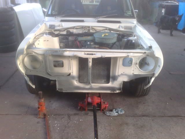

this is where im up too ATM..
rad suport all strait:
pannels all mocked up:
also built my coilovers, there aus spec 120y's, i just used an ebay style 51mm kit with a extra sleave, then choped the struts 80mm to suit pulsar shocks..
this is how they sit with spring just captive, also had to pump the gaurds a tad:

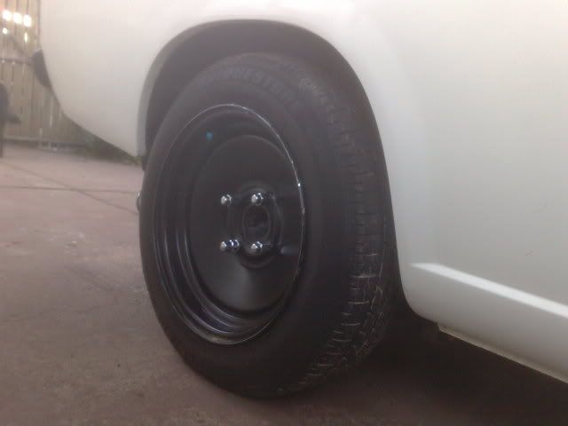

also some 14x6 +2 steelies i found, just need to have some leaf packs reset flat for some more lowness:

dont paint the centers on the enkies, polish ftw. might as well use rebels of painting black or some rubish rime like a.... mmmmmmm jelly bean
how wide are those steelies? not much beading going on there, and what ttyre size. was looking at some 155 70 on 13 x 6 but will roll of for sure
Posted on: 2009/5/22 14:57
Re: scotty's ute.
2006/5/27 6:17
From cranbourne, vic
Posts: 299
i would probably keep my 13'' jellys, but there only 5'' wide and FAIL offset!!
the rears are 165/65/14 on a 6'' wide rims, the bead on these rims are huge, they came with some 185/70's and the bead still was out side the tyre, 165's are the limit for me on these 6's
