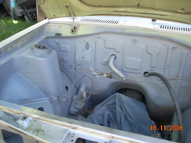

Just got it regoed So now to do some work as it needs a bit of TLC. Collecting al the bits to rebuild the front suspension and a bit of upgrading.

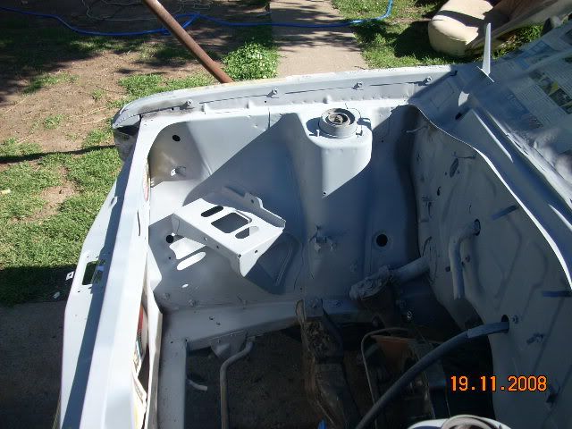

Droppin the A14 in it So decided to prep and paint engine bay for new color Saves pulling out the donk when i paint the rest of it.

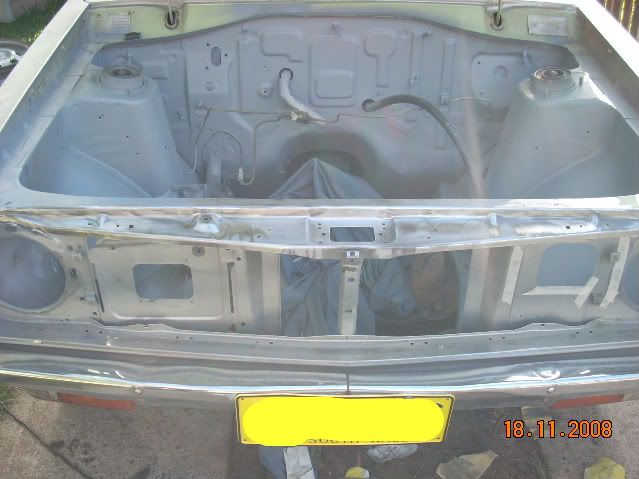

Getting there Just going bare metal on all the seams and surface rust with a wire wheel.
Will etch what i've done and kick on Tomoz

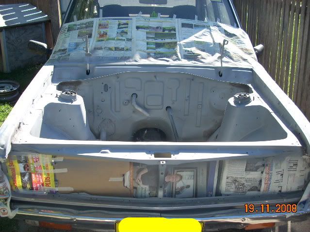

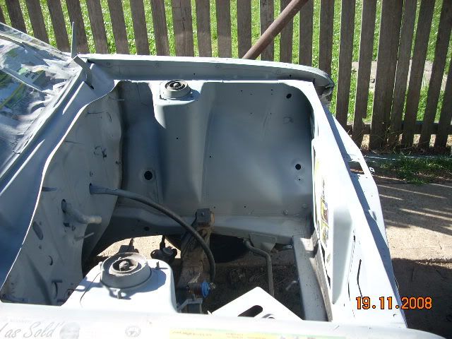

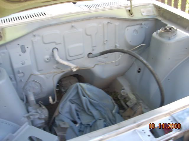

Some Updates, Etch Primed and 2 coats of primer filler. So fiddly hand sanding this bit but rewarding.
Bare Metaled all the top of Radiator Support panel, Etch primed Pick to come Tomorrow.

All masked and finished etch priming inside edges etc also applied 2 coats of primer filler now to 800 the lot and repair any runs etc. color tomorrow, weather permitting
