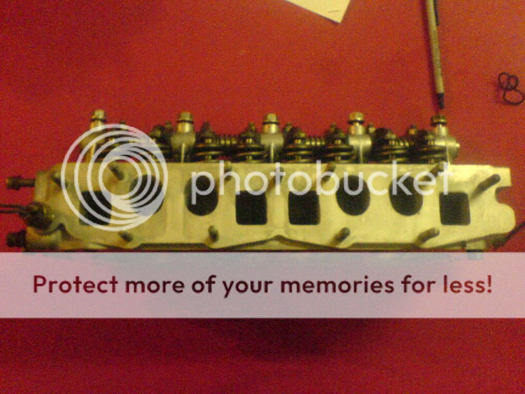

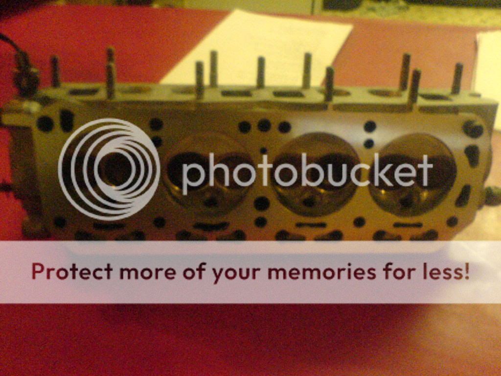

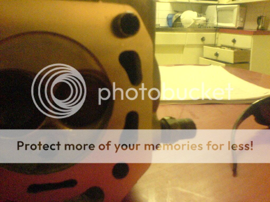

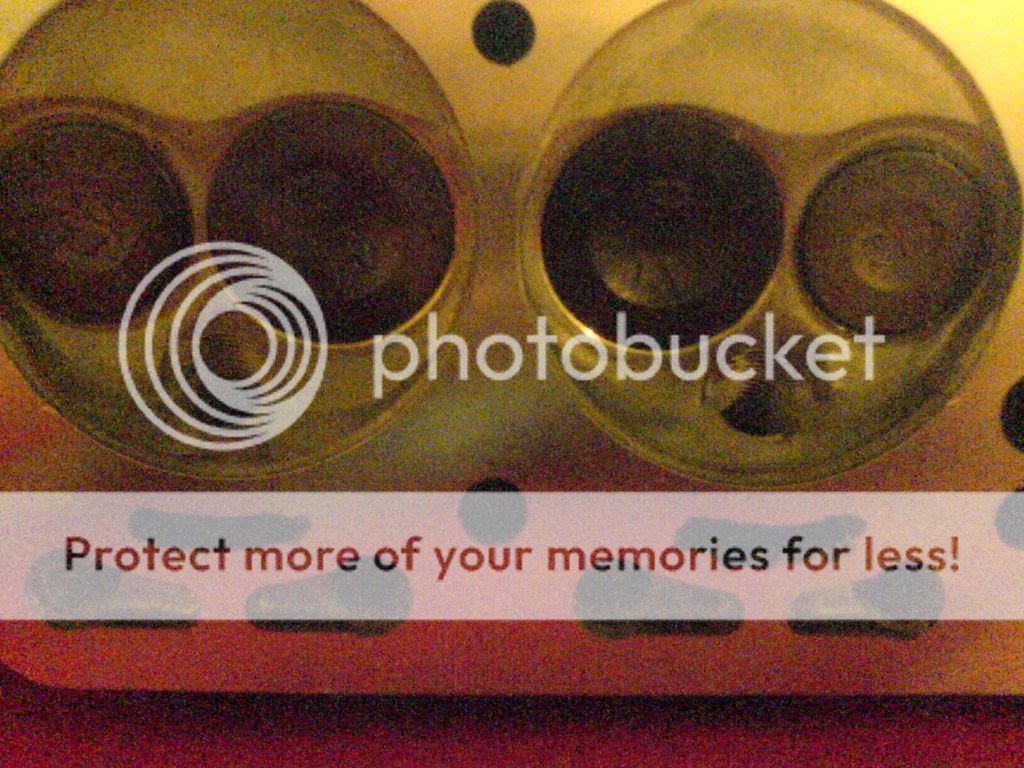

I'm so pissed I forgot to take before shots of my head cos it was really bad.
the rear water galleries had corroded out within like a few mm of cylinder 4 and the ones along the length of the head were not pretty either.
Here's what it looks like now
Here's the rear galleries nice and filled up w new metal
And a couple of the others, man the corrosion was bad!!
So now to clean the block and get the datto back on the road
