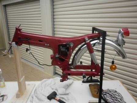

Here you go Jesse, few pix of the bike. Engine re-built, Frame painted and new loom installed.
Now need some motivation in regards to the datto. Made up some templates from some rear mud flaps but that was as far as I got.

Nice work jarrad the bike looks mint ! Cant wait to see it when its done
Now chop chop get the datto ready for the all jap day :D
