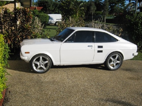

this is my 1200 coupe, its kind of a slow project that i still drive.
i bought it pretty much how it is at the moment.
it has CA18det and 5 speed box, turbonetics turbo and external gate, ems4860 computer, 706cc injectors, apexi boost controller, front mount intercooler, plumb back blow off valve, r31 fuel tank with walbro pump, r31 diff and brakes on rear, s13 coilovers and camber tops on front with s13 brakes to go with it.
since i have had it all i have really done is put in all the basic things to get it roadworthy and registered.
made up an alloy dash plate to replace the mdf one that was in there, and just tried to generally tidy it up a bit.

Very nice dude, Keep us updated.

very nice!
it is really clean ohh yea that dash is sweet as too.
quite a tidy little ride ay
