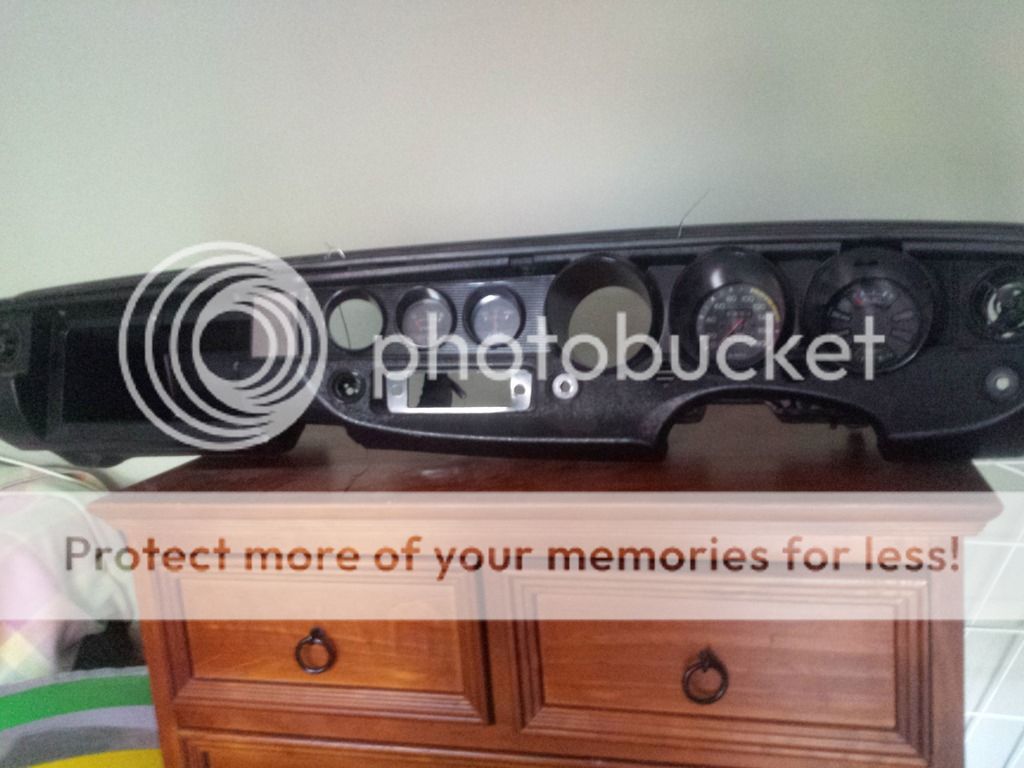

trb012 Posted on: 2015/8/24 2:10
Swapped this for the rolling coupe shell on the weekend. GX coupe dash so stoked to have finally found one will get a resto then go into the sedan hopefully have it ready for Melbourne jap day this year.

ddgonzal Posted on: 2015/8/24 3:41
Very nice. It makes a B210 classic looking.
* Fitted to JDM Coupes (including DX). Of the Sedan, only the GX got the round-gauge dash.
* It can use the GX speedometer (180km) or the DX/GL unit (160km).
* For the 3rd large hole, a Tachometer came with GX, Clock with GL, DX got a blank plate. Econometer was fitted in late B210 non-GX.
The three small gauges were:
* Early B210: Clock, AMP, OILP
* Late B210: Clock, Voltmeter, OILP
* A12 models got a clock blanking plate

trb012 Posted on: 2015/8/24 4:56
Thanks for the info dd Ive got the tach as well and the sunny blanking plate for the 3rd hole has the 180kph speedo too. Will either get the standard gauges restored and place a vdo or similar boost,oil pressure and volts in the smaller spots. Or replace the lot with custom speedhuts haven't decided yet.
