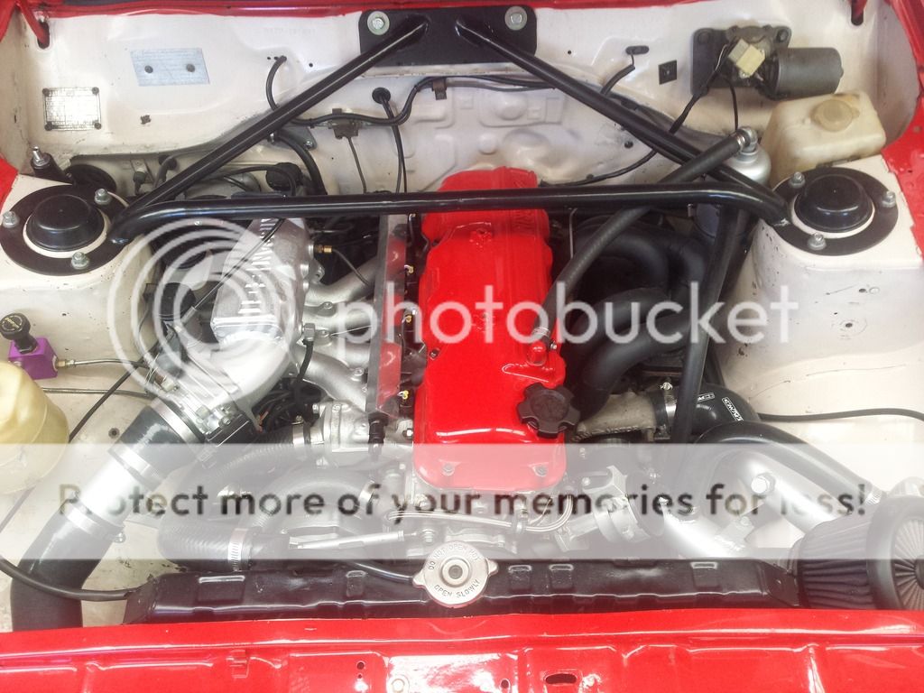

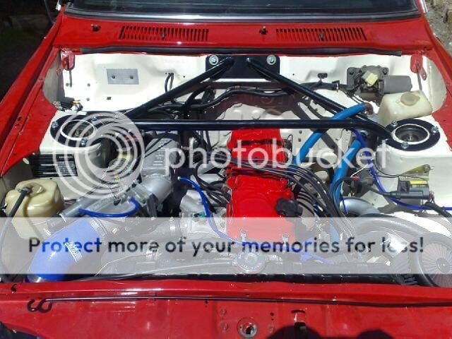

#64 Re: trb012's 120y 2door sedan
ddgonzal Posted on: 2015/9/8 5:49
Ah, I see now: 4-plug Z18T engine
BEFORE:
Now has non-distributor spark control, different Throttle Body and different Injectors
I also see a new Brake Proportioning Valve (where the LPG Certification plate used to be) and the coil on the left strut tower is gone.

trb012 Posted on: 2015/9/8 5:45
I ment the conversion from lpg to E85/petrol as even though its a factory efi engine everything was removed from it when it was on gas fuel rail,injectors regulator ect. Also no longer runs a dizzy now had 4 ls1 coils here's an early bay pic to show how much it's changed.
#62 Re: trb012's 120y 2door sedan
ddgonzal Posted on: 2015/9/8 5:28
That engine bay looks identical to a petrol engine ... ?
Now it looks like it has a standard throttle body, whereas before it had a special one
Before:
