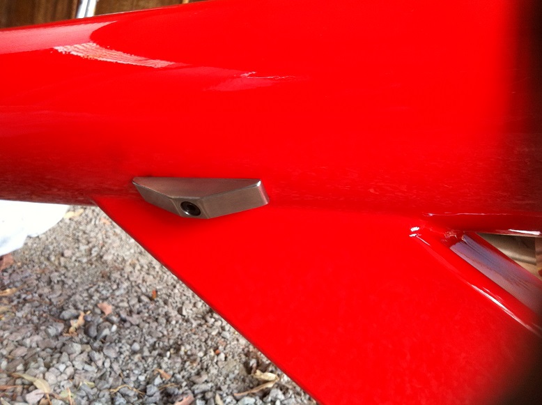

Posts: 1309
Its a product made by Valspar(Netherlands). Its 80% Binders and uses concentrated tinters. It covers very well and only two coats are recommended. 10 mins between coats at 25degC. 10 hours dry time(workable) at 25C, but it takes days to get to its full hardness.
I bought it from the local auto paint place. 5:1 ratio with hardener and 10 to 20% reducers(fast).
The recommended surface preparation is to Blast it. I used an 80 grit steel blasting media.
It cost about $48 for one Ltr. But you will also need the hardener and reducer.
