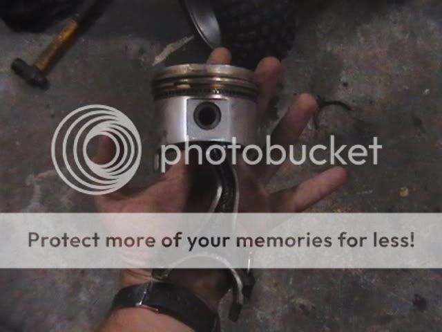

I've never seen an ARP bolt let go on an A series... or a standard one for that matter.
I have seen the standard bolts fail, this is the result-
This happened to my suck through turbo set up years ago, left side bolt snapped and was found in the sump in half, scratched the sh!t out of the bore, both bearings were mangled. Did i do a good job or what?????
Never seen it before or since.
