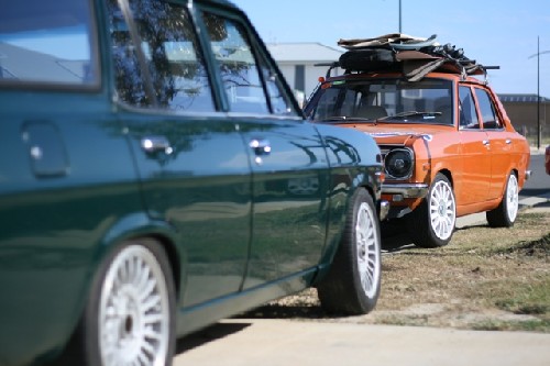

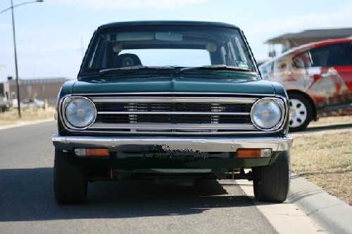

polished the wagon yesterday for Nick
jpg  1.JPG (70.97 KB)
2709_50ef87a6b63e7.jpg 800X533 px
jpg  2.JPG (42.68 KB)
2709_50ef87be76452.jpg 640X427 px
jpg  4.JPG (50.33 KB)
2709_50ef87d1de159.jpg 640X427 px
jpg  5.JPG (50.73 KB)
2709_50ef87e312c61.jpg 640X427 px
Posted on: 2013/1/11 3:33

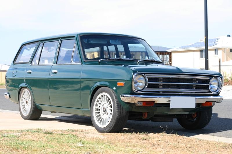

and the last pic photobombd by my sedan !!!
jpg  6.JPG (44.18 KB)
2709_50ef884923810.jpg 640X427 px
jpg  7.JPG (49.21 KB)
2709_50ef884fbba66.jpg 640X427 px
jpg  8.JPG (52.21 KB)
2709_50ef8859815bb.jpg 640X427 px
jpg  3.JPG (117.52 KB)
2709_50ef88633e222.jpg 640X427 px
Posted on: 2013/1/11 3:35

Looking swwwweeeeeeeeeeeeettttt boys

Looks good and hope it stays like that

That looks awesome, I'd love a wagon.

And thanks for chucking the pics up adrian, and i guess for spending several hours making the paint look like it should
