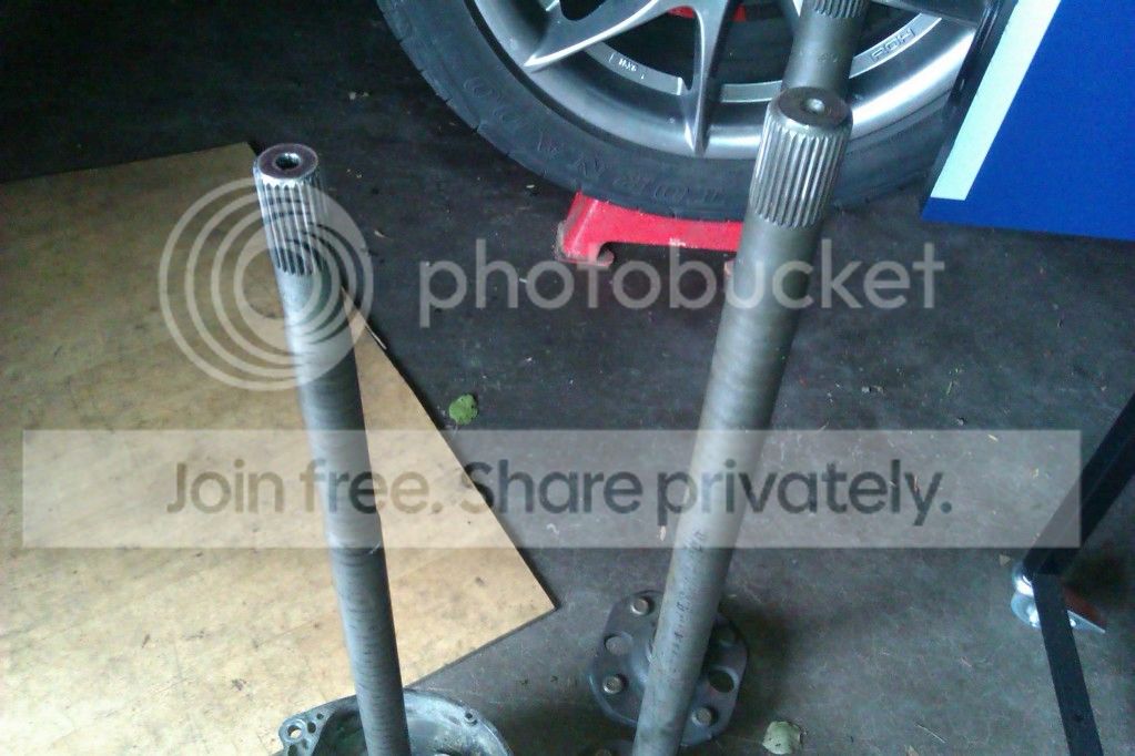

1200rallycar Posted on: 2012/9/18 7:52
looking at diff stuff again
bluebird and vanette H190 use same axle bearings, but check out the difference in the axles!!!
good news is it looks like i can shorten the bluey axles to the right length, and the wheel bearings being the same I can probably use the vanette housing in the car already, as long as the bluebird centre will bolt into it
fun fun, i have to pick up the bluey center from my brother before i can do final measurements

Massive difference. Does he have the blinked housing to.fit if the blue bird centre doesn't fit h190 housing?
Or will you just use h190 to match your LSD?

yeah thats more what h190 axles should look like, the other ones look like they are only h165 size
