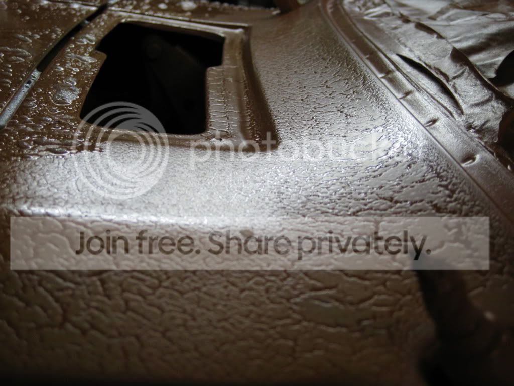

but first what happened on tuesday night when we applied the pearl
we painted the pearl over the orange, we were told by the paint place that the pearl was in a binder and didnt need to be put in clear... unfortunately we followed that advice and above is what happened

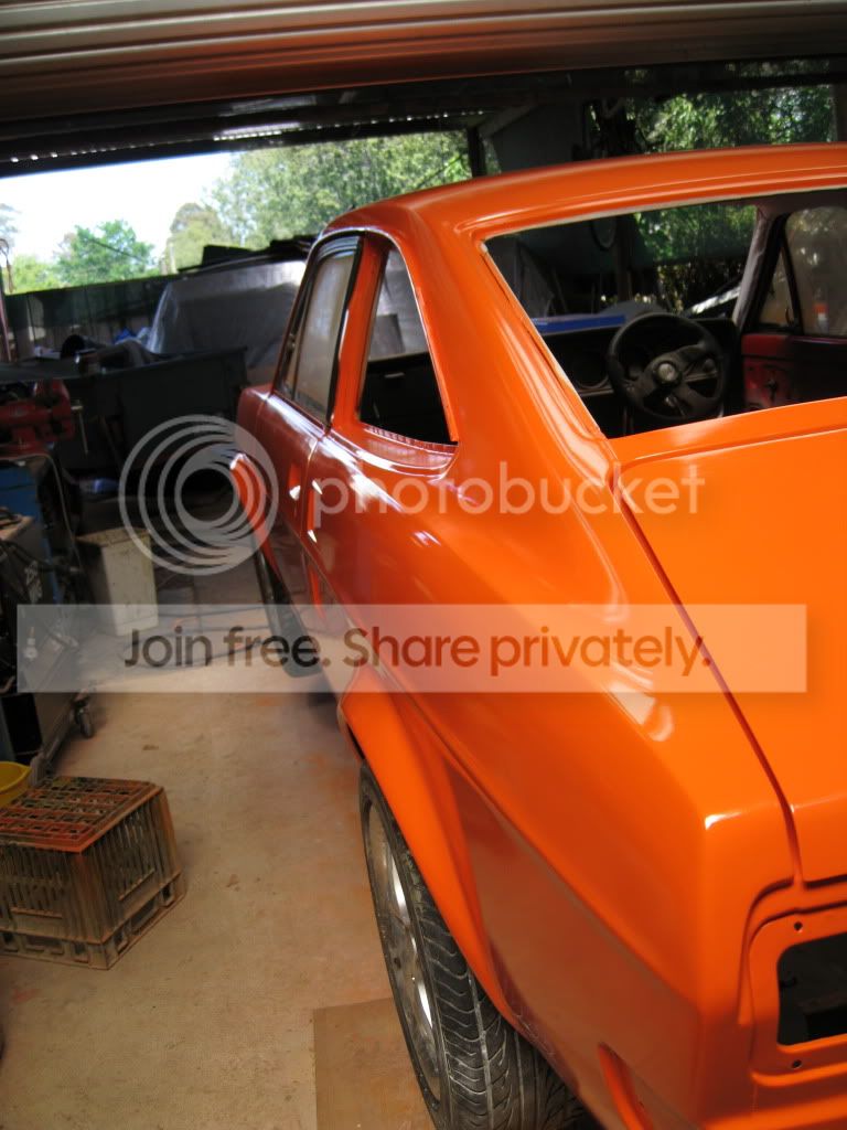

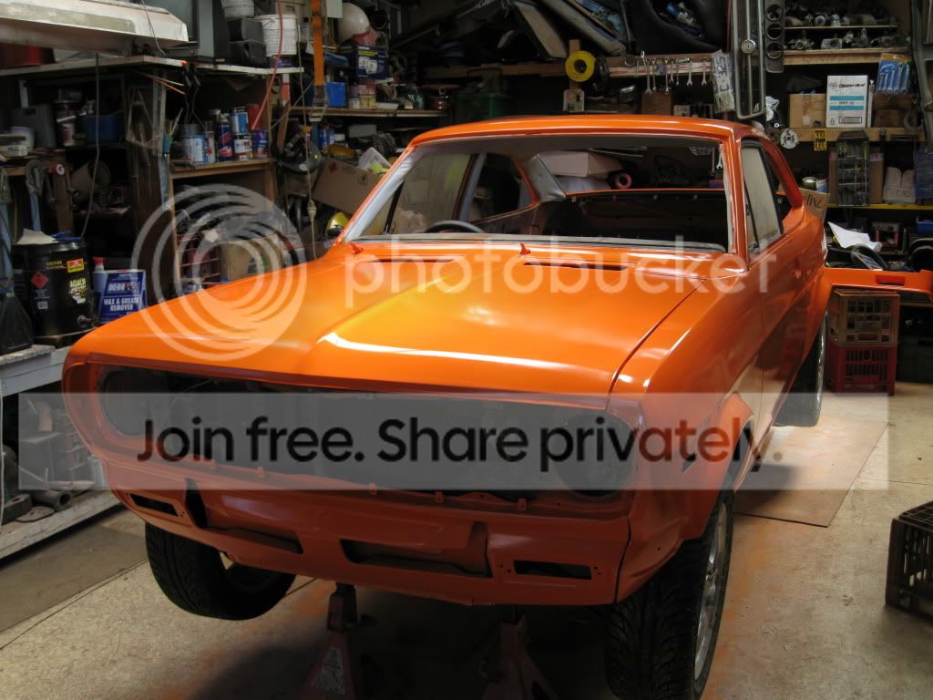

now what it looks like after we sanded off the pearl, re-applied orange coat, then mixed the pearl into clear, and finally four coats of just clear
we havent cut it back yet so this is the result straight out of the gun so far
colour is a custom orange (basically as bright as possible) with a light gold pearl over the top which features a blue on the flop
