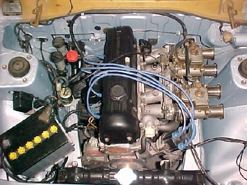

mine took me about 6 months to do,L20 twin 45s 5 speed. i just cut about half the motor mounts off the standard xmember and it helps to have an auto tunnel.all up i got away with doing the whole job for about $1500. $300 bluebird,$250 tailshaft,$800 carbies rebuild, and other little bits n pieces.

i'll bet it goes alright too! I think for now i mite stick with the a15, just cop i.ve got it already as well as most of the parts. Cheers for the help tho guys
