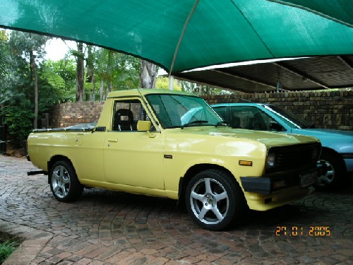

Hi Guys
I'm South African, also playing around with the A14 and A15 engines. I have a A15 which is turbocharged with original fuel injection manifold, aftermarket injectors and comuter.
Do any of you know where I can get more of these intake manifolds?
Regards
Pshycho
