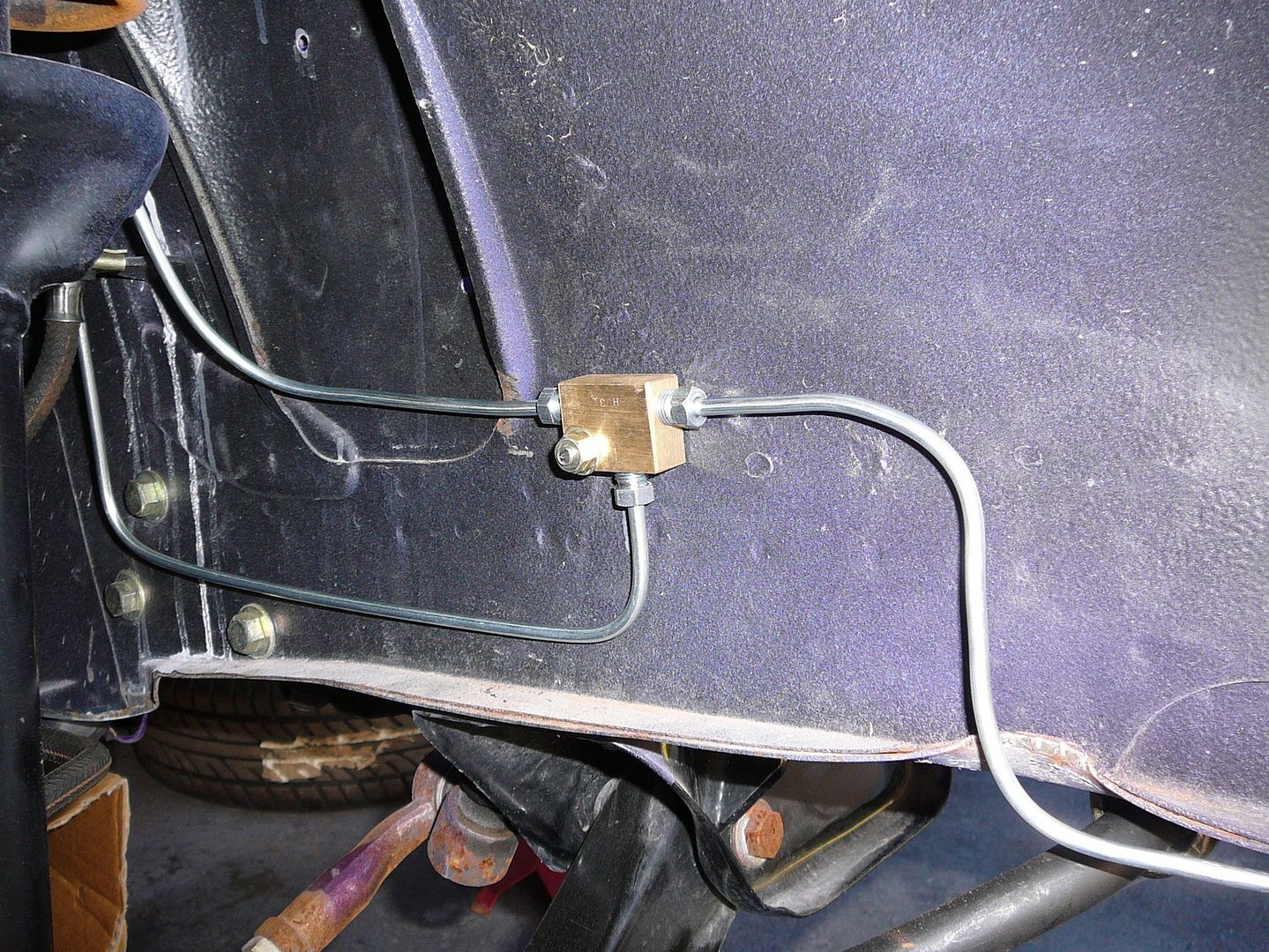

what's the brake line bolt thread, is it 10mm x 1m NF24?,

out of sight for brake lines

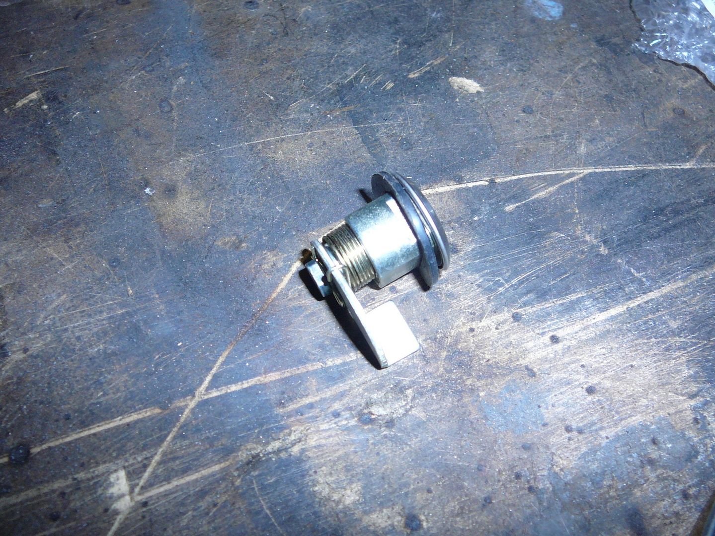

fellas i need a lock for my ute fuel lid, hoo has one to sell or can you still buy new!

cheers fella's found a new lock from Canada,

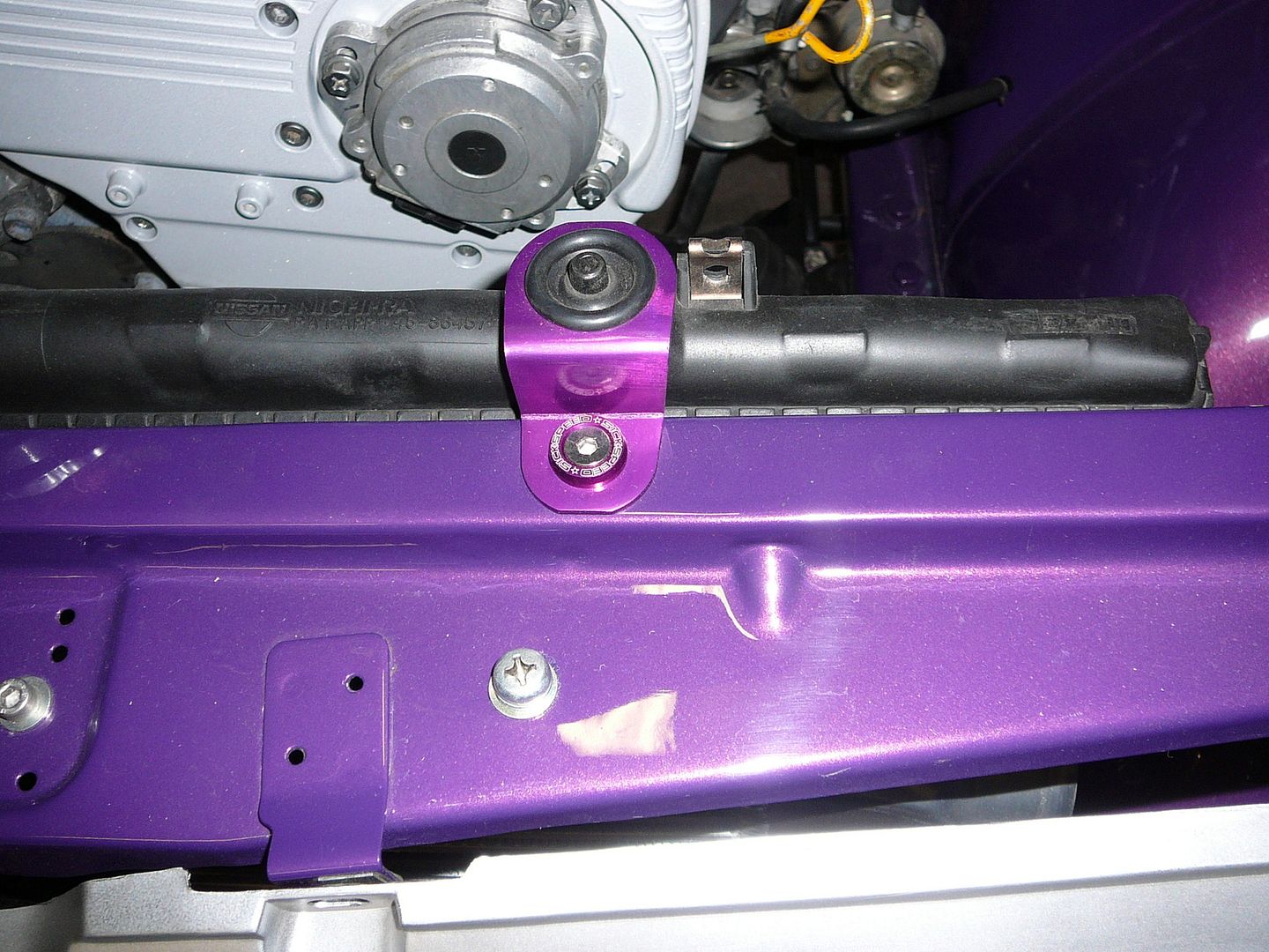

new rad brackets (sickspeed) suit Honda civic, full rubber grommet with hole punch out

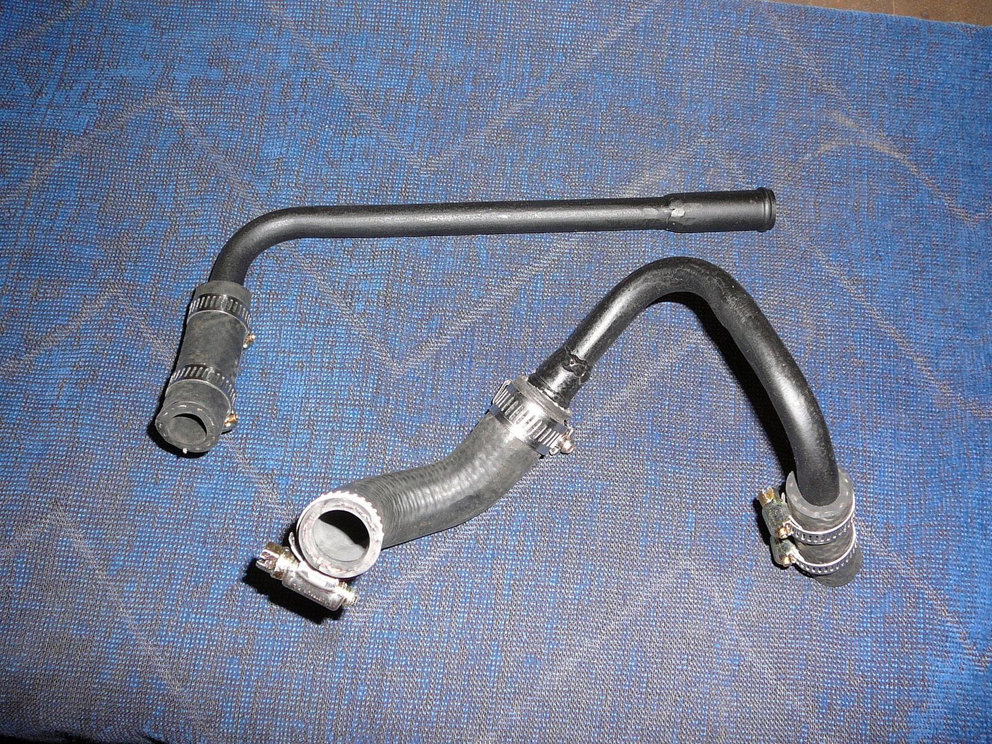

custom made CA/1200 heater pipes using original 1200 heat unit

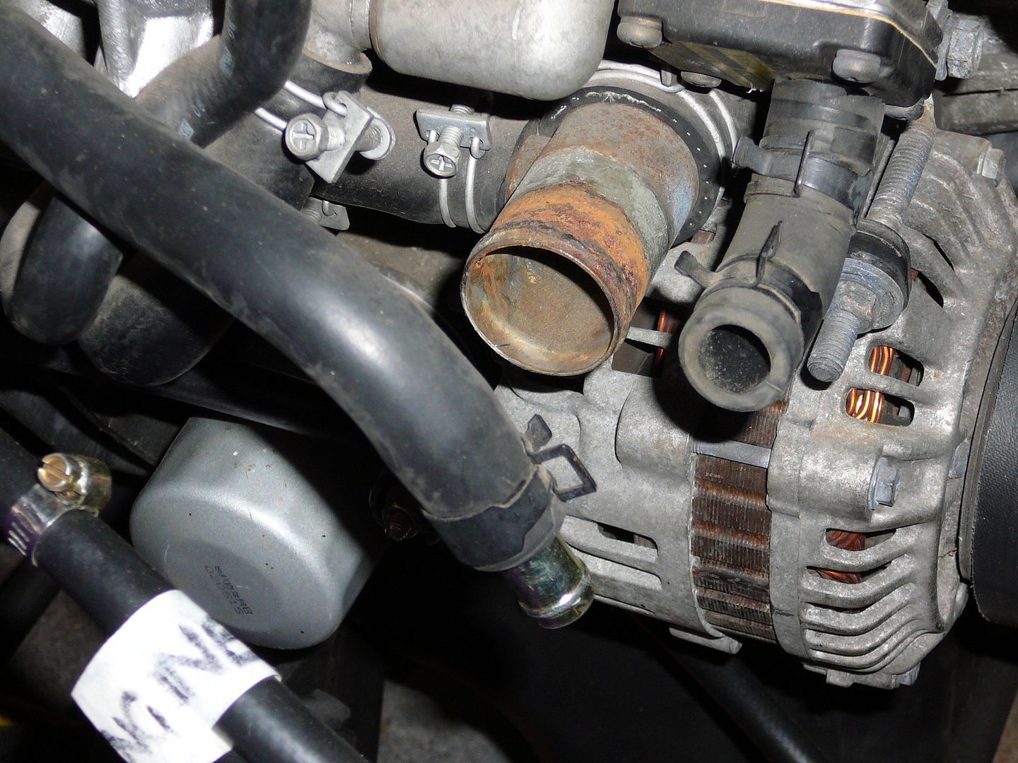

where do these two small pipes go, what runs through them water or air??
maybe to intercooler
Posted on: 2012/10/17 3:09
living is good,.....

This is lookin sweet Rod. Can i ask where you found the Radiator brackets ?. Looked on Sickspeed site cant find them under Honda Civic

the right answer is BOTH water and Air (but not in the same pipe(s))
I will go and take a couple of pics and post up what mine looks like
Posted on: 2012/10/17 5:15

big one goes directly to my bottom water pipe on my radiator
little one picks up the pipe you have on the left and also the breather on the top of the rocket cover and then goes to the air intake between MAF sensor and Plenum ....remember i am not running turbo

Yeah DET is slightly different but there for Air/breather and pretty sure you know what the bigger one is i have DET sitting here can show you a pic if you like.
