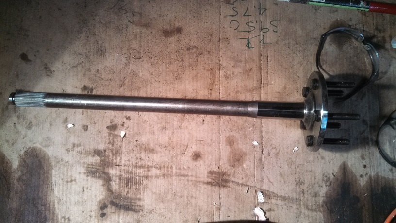

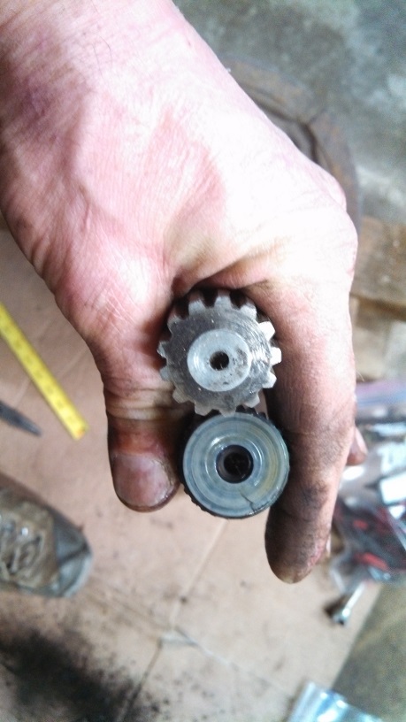

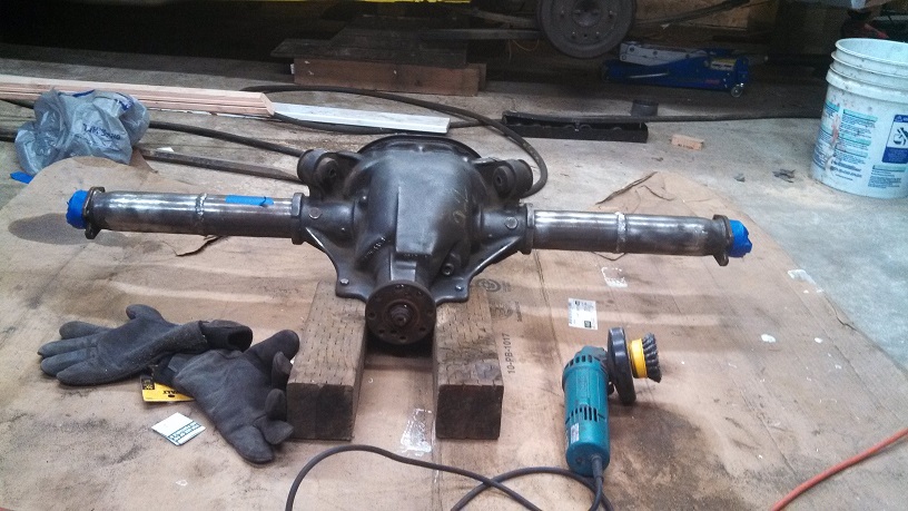

Worked on the Ford 8.8 today. Got it wire wheeled and painted although I will have to re-wire wheel it when I weld the leaf spring brackets on. The axles should be here tomorrow. I just need to pick up some more steel tomorrow for the leaf spring brackets and I plan on reinforcing the welded tubes.
Also, here is a picture of the old Datsun 320 13 spline axle compared to the Ford 8.8 28 spline. The 8.8 outside diameter is 1.22 inches compared to the 320's 1.14 inches but with the 320 being a 13 spline, the strength is weakened by the deep grooves.
