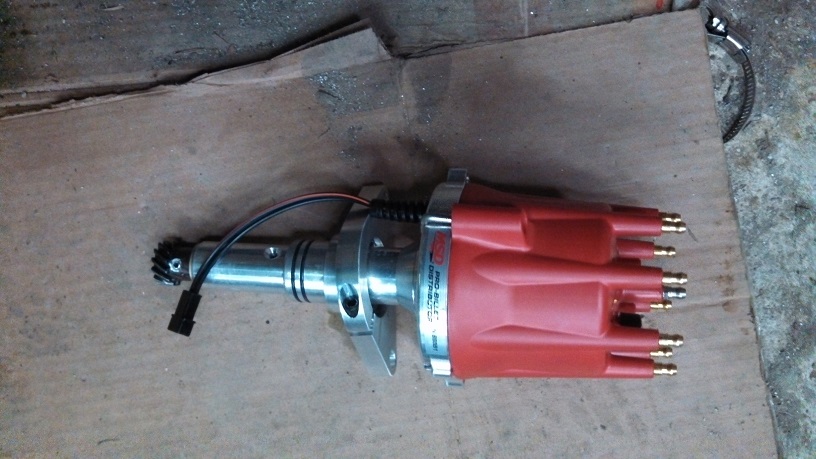

Picked up the MSD distributor today. Guy did an awesome job on it. The contacts on the cap that are not going to be used are removed from the underside of the cap.
