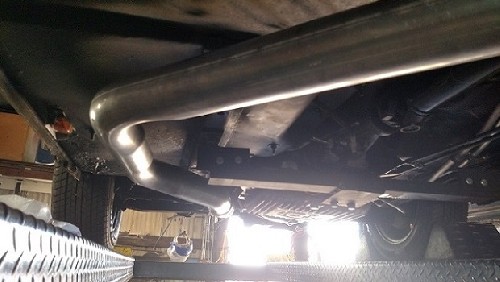

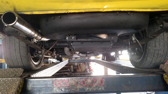

datsa73 Posted on: 2015/4/20 6:05
Pictures from under the car when it was at the exhaust shop.
Tranny cooler in the rear with 2 fans mounted on top.
