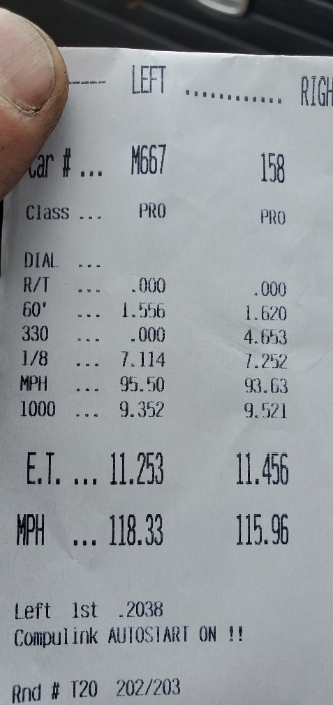

Saturdays race at Pacific was a success.
5 passes on the new motor with no problems. Best time was a 11.38 at 118 mph.
Set the ignition timing at 26° BTDC and retarded 9° from that when on a 100 shot of nitrous.
I was the only import in the PRO class racing against american muscle. Lost in the third round to a 60's Chevy Nova wagon.
Best pass of the day was a dual perfect reaction time. I have had perfect times in the past but never seen both.
Im number 158 on the time slip.

Thats fast !!!
I'd wish I'd made copies of my 1/4mile time slips as all the print faded off them over time

Thanks.
Going conservative this year. Spent to much money on a brand new motor. Will try and run it again this weekend and then change out rear gears.
The car was pushing hard to gain speed towards the finish line. Going from 4.30 to 4.11.👍
