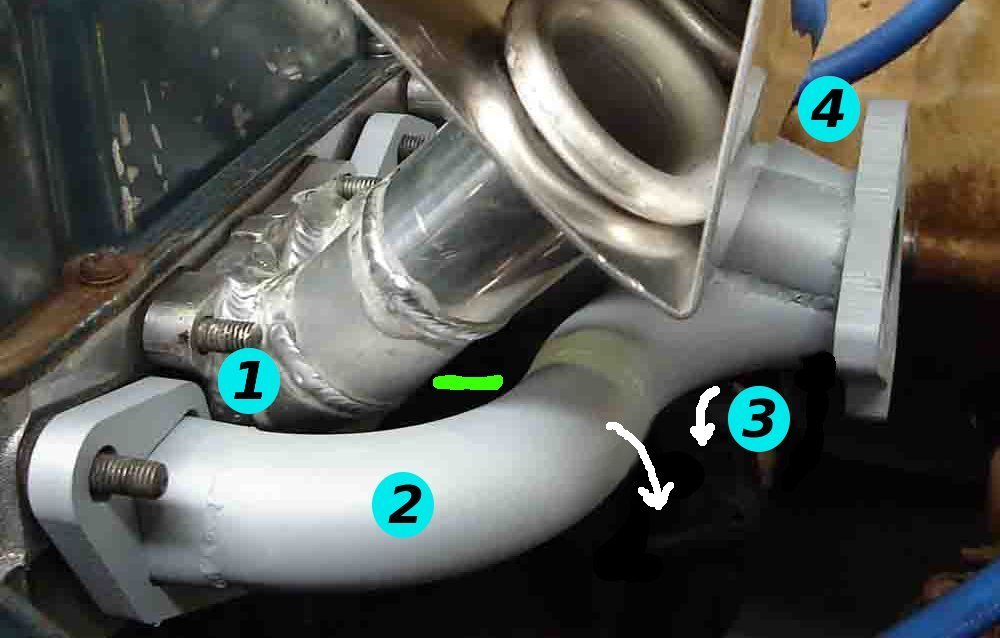

I just want to help not step on anyones toes and I can only thank what Sikyne and Jmac with
Simons handy work making manifolds for me and others at his workshop really hitting home.
Just using a separator will make that a T intersection like hitting a wall dead on.
Turbulence will reduce efficiency overall more than 5-10 per cent claimed to around 25%.
With a little rotation and grinding off the 1 and 4 bends the 1 and 4 collection points
meeting the flange will be more angled relieving the T instersection effect.
The other option is the true and tried TOPGEAR manifold which is the ultimate and very little use of material also but ultimate flow.
When I say True is that from 33hp at wheel it improved to 128hp almost 4 times improvement.
Even that manifold could be improved if you look at the picture
A.
types of bends in blue circles can be 1.2,3 and 4 (1 is square, 2,3 bends and 4 straight pipe)
B.
The white arrows are where you can rotate 2 and 3 bends down at that point then number 4
can be a straight pipe and also allow more inlet manifold clearance (indicated in green).
Pieces total excluding flanges: 4 square, 4 bends and 2 straight.
jpg  topgear.jpg (87.40 KB)
737_4c3530785a63c.jpg 1000X638 px

i am going to be redesigning and making two different manifolds only because of the interest i have has so far with the first design. The first manifold does have a divider between the collector,the way it was fabricated is with a weebbing in the middle joining the two pipes to the diameter of the t25 flange. (will provide pics)
i am also going to be making some up with all 4 pipes meeting at the collector as D has suggested although these will be of higher expence as there is more fabricating and time required (price yet to be confirmed)
