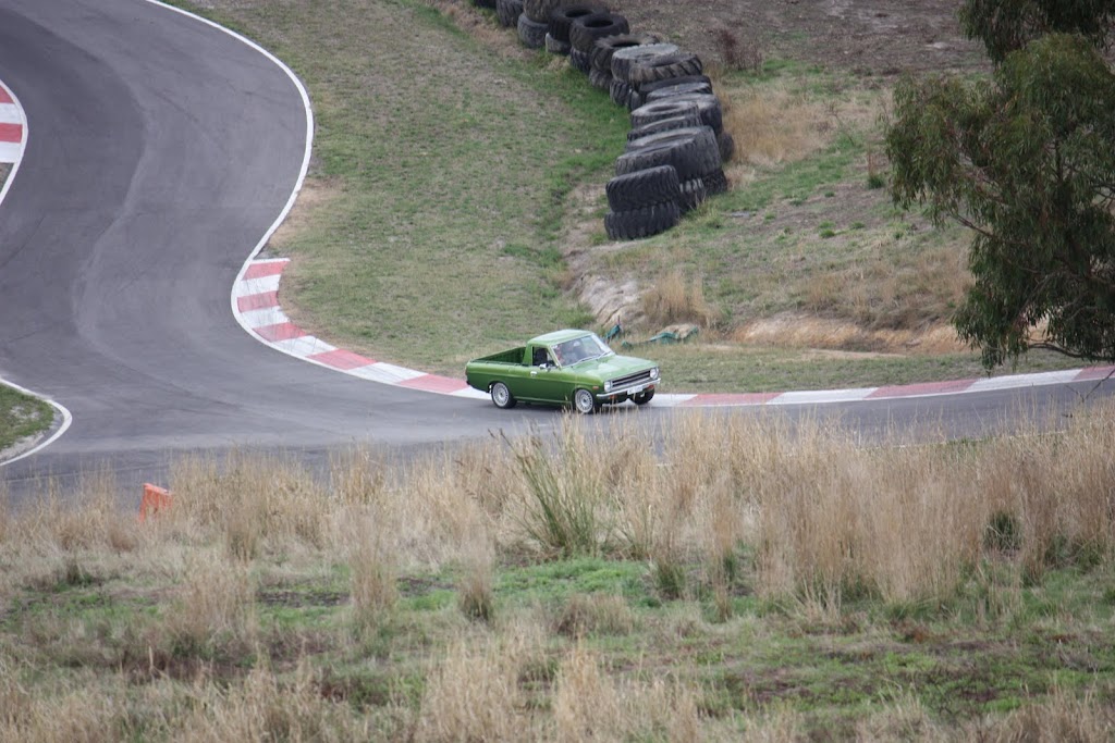

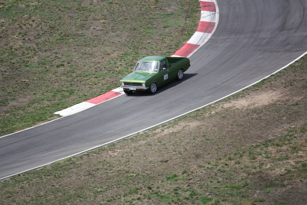

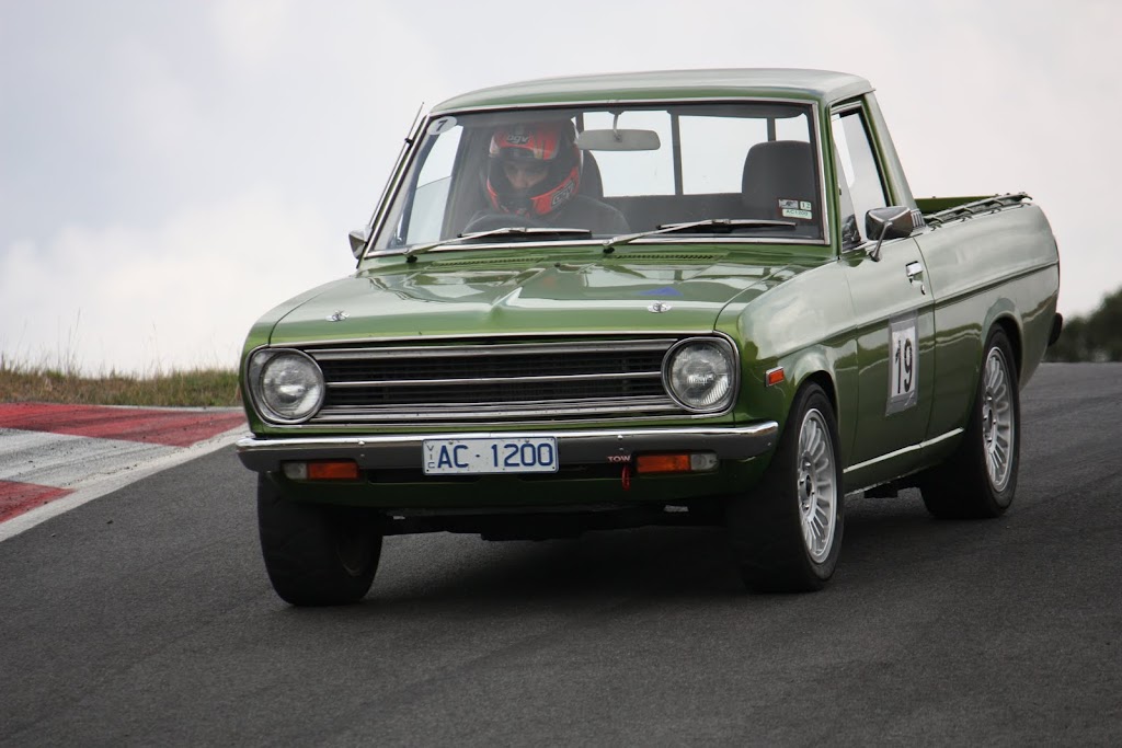

pics

lol look at the lean in the ute ang in that last pic its full of roll. im with wat other ppl say, stiffer front and little softer back, i have to do some sim mods to mine as my setup is un balanced, i have piggys front modded front struts just need stiffer springs, and have sway bar setup in rear and it just causes troubble as it is setup for stock height not 4inches lower :)

Are you driving with the window down in the last shot ??

window half up in the first shot but its all the way up in the last shot
