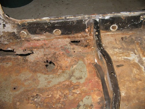

Did some poking and scraping today and came up with some lovely holes The rail is R/S and the whole drivers Floor is R/S.All the holes in the old floor were bogged and had old underfelt glued over them even the rail was filled with bog and some plate riveted in to catch the runny bog. Scary part is the person who did it could weld as there are plates in the lower section where kick panels go. What are some people thinking ?. So cut it all out there was a bit of rust in the corner of the footwell to so cut that out. Now to cut all the good sedan floor and footwell out and unpick rail near steering box to replace it all in one section.

DatsAndy Posted on: 2010/11/1 8:28
Tacked in drivers floor today after a bit of a clean up with a flapper disc we took the rail and floor pan out of parts car as one piece. It was a bugger unpicking the spot welds on both cars just cause of huge spot welds in the section below steering box. Also took a plate out that we suspected was covering a nasty where kick panel goes and WOW a bogged up rust hole hence no dog leg. So off to the parts car i go again and ebay member has the 5 piece section to complete my missing pieces. Going to be a mig master when this things done.

DatsAndy Posted on: 2010/11/1 8:36
We didn't muck around well not for a beginner took a panel beater mates advice. Cheap ones can only go so low and low is a need for thin stuff as you can imagine. Got the lincoln 180c gas/gasless it welds thin stuff gasless and I'm convinced it would be even better on gas. It loves welding big stuff mate the thicker the better it seems.

DatsAndy Posted on: 2010/11/2 6:39
That's it mate Didn't take what you said as offensive, all good. Not much today just started welding in the rest of the footwell and started cleaning up some of the other welding jobs so i can prime the whole front in and out.
