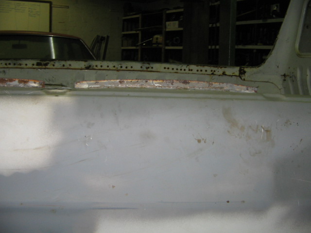

DatsAndy Posted on: 2011/5/13 11:26
Got the sill migged in today. Cleaned up welds etc and threw a bit of primer over it still got to tidy up a bit more and smooth out joins but very happy one of the big hurdles overcome now.
