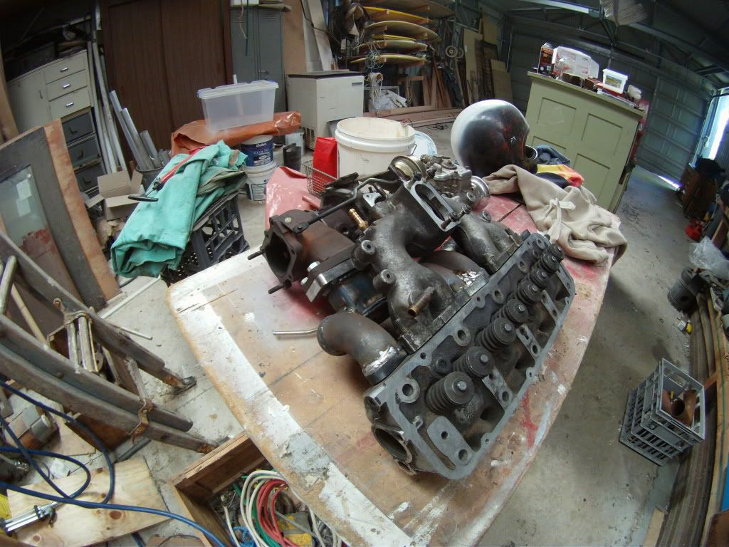

Nice looking turbo setup Casey! Should be fun! Did I send the info on water pluming to you? If not I pulled water from bottom hose via I temp gauge fitting ie 1/8 fitting and then return via opposite side to temp sender in the h75 head as mine had an area to tap into, if yours doesn't u can return it to the heater pipe at the back of the head! Hope this helps Ta nick

Nice setup there casey ! Going to look sick with a weber and a turbo
Best of both worlds !

yea that head is an old coona i welded my manifold on im also using a h75 and im gonna get rid of my heater box so il probably just plumb it in using those lines in that it will go to the turbo not hte heater then feed into the back of the head. just nutting out how to get it all to fit shes abit tight atm and just finnishing my other motor to bolt it all to

casey Posted on: 2011/5/17 4:26
well have been flat out with study and havnt touched the ute much. but turbo motor is mostly done. just waiting on a timing cover and i need to get off my ass and set the valves. pre-fitted my manifold and turbo on my current motor. needs a little tweeking as it hits the strut tower. constructive critasism about my manifold would be handy but try not to hurt my feelings i did it myself haha. it is set back that far because im using a webber and it wouldnt fit otherwise.

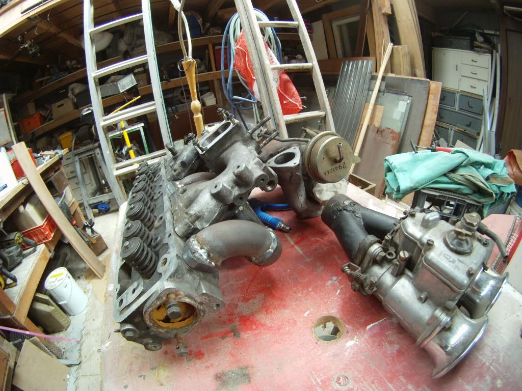

casey Posted on: 2011/6/13 8:37
righto new black motor whent in the ute last night, just waiting on a new intake/exh gasket to fire it up. yellow motor shows how the turbo set up mounts nicely. need to play with it a smidgen to clear engine mount. but no majour mod. and with my old motor i stored it in my racecar for #OOPS#s and gigles, a bit smaller than the 410ci motor that should sit there

CA_1200_project Posted on: 2011/6/13 11:36
Looking good casey!
Turbo set up looks good mate so be proud you made that :)
