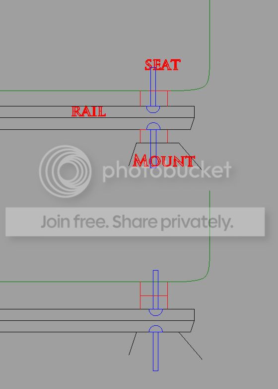

2007/2/26 20:47
Posts: 595
Ok So the rails have been made up and ready to put in, though now Ive realised I need an additional 20 or so mm of clearance for the seat frame to clear the crossmember!
I had some shims made just in case this happened, 10 and 12mm, but now it looks like Ill be needing both sets.
I initially put them on the top and bottom but now im thinking the thinner, lower part of the rail needs more contact with the mounts for strength, but putting both shims between the top rail or the seats 22mm of shim seems a bit high for an 8mm dia bolt.
hers a pic not to scale...the real thing looks dodgier
n...I know its a bit of a 6 of one half a doz in the other thing but which option would you guys choose?
