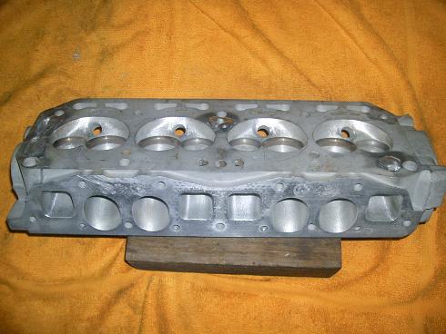

welded and machined, do things right the first time and everytime. (don't play games, allways bites you somewhere). thanks or "you can do this(not finished yet)
jpg  PIC_0321a.JPG (76.74 KB)
9764_4c2dfb0e41611.jpg 490X368 px
jpg  PIC_0323a.JPG (78.86 KB)
9764_4c2dfb3774025.jpg 490X368 px
jpg  PIC_0319a.JPG (70.85 KB)
9764_4c2dfc20236c4.jpg 490X368 px

Okay so that one is midway through some repairs to corroded galleys on the block face and manifold face?
That first GX head you showed has a very straight edge on the back of the combustion chamber beneath the spark plug landing, interesting because I've never seen one with such a straight edge, or I've never paid close attention. It's probably no big deal but though I'd mention it.

Combustion chamber not heart-shaped, but kidney-shaped
