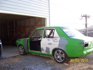

So far I,ve only have put down the first colour and its still off the gun, I,m thinking now that a wont do a clear coat. My thoughts as far as masking for the second coat that its best to do the second mask using the least sticky masking tape I can find and to keep the first colour off the gun. By cut and buff I mean compound cutting and wax polish........i,ve cut and buffed a small section and its going to look good....megga shiny.

why is there still grey bits? am i missing something?

Photo shop would be great thanks......yep can see your point about the grey. If you look at the last two pics, this is at the prep work stage, i,m painting green over green so the prep work thats still showing in the top pic is where the black will be, as the origal colour was green its a bit hard to see at this point what will be what. The black strips will run over the bonnett, roof, boot and down the back of the beast. If you also look at the first pic you can see grey on the sil and top of the door shuts, these areas will also be black along with the top of the door frame........

ok im getting it now, if it was me doing it i would have painted it in a clear over base. painted the whole car green, let that dry for a bit, mask up for the black and hit the black up then unmask, tack cloth, hit the whole thing with clear.
