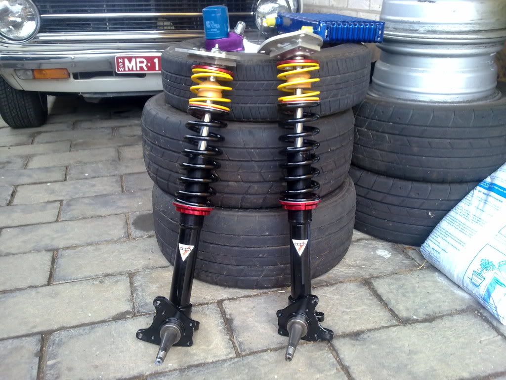

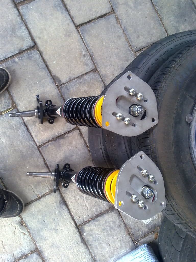

So i got my coilovers back, complete. They are made up of 120y struts shortened with HSD coilover sleeves welded on, externally adjustable KONI shocks, and andos spec camber tops. They swapped the standard tendercoil for a King spring one because the standard one didnt suit my setup. Also painted up my s13 calipers and hubs. Ordering the pads and rotors this week, aswell as some braided lines. Cant wait to get it together and go for a burn
