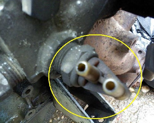

I am confused on a part thats on it. I would really like your guys suggestions,do you know what they are for as my 1200 is stock weather I should use them or not.Thanks...

This circled in red is EGR. Datsun 1200 did not use it. The 1200 met even the tough California emissions for 1973 with using the EGR valve. You can leave it on the engine and it will do nothing, it will not affect performance.
Posted on: 2012/7/16 8:23
Re: Datsun 1200 sedan project..
This part is a thermal vacuum switch. It connect the two hoses when engine is warm. I would leave it in the engine, as you need something to keep the coolant from leaking out. Or you could remove it and find a certain bolt or plug, but who knows what size it is?
Posted on: 2012/7/16 8:30

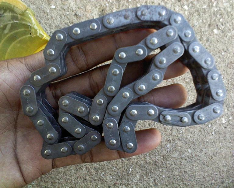

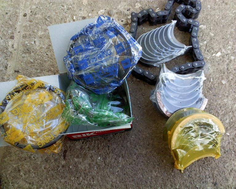

Here are some part that I baught,Taught i'd post up a few Pics.Enjoy
