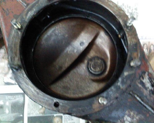

More 'updates' i took out the diff and stared to work on it did not take long to come out. i want to put an h150 into it.an alloy centre
jpg  Pic02101.jpg (77.64 KB)
12526_4d94872b0ea97.jpg 771X461 px
jpg  Pic0216001.jpg (52.05 KB)
12526_4d9491faaf714.jpg 640X512 px
