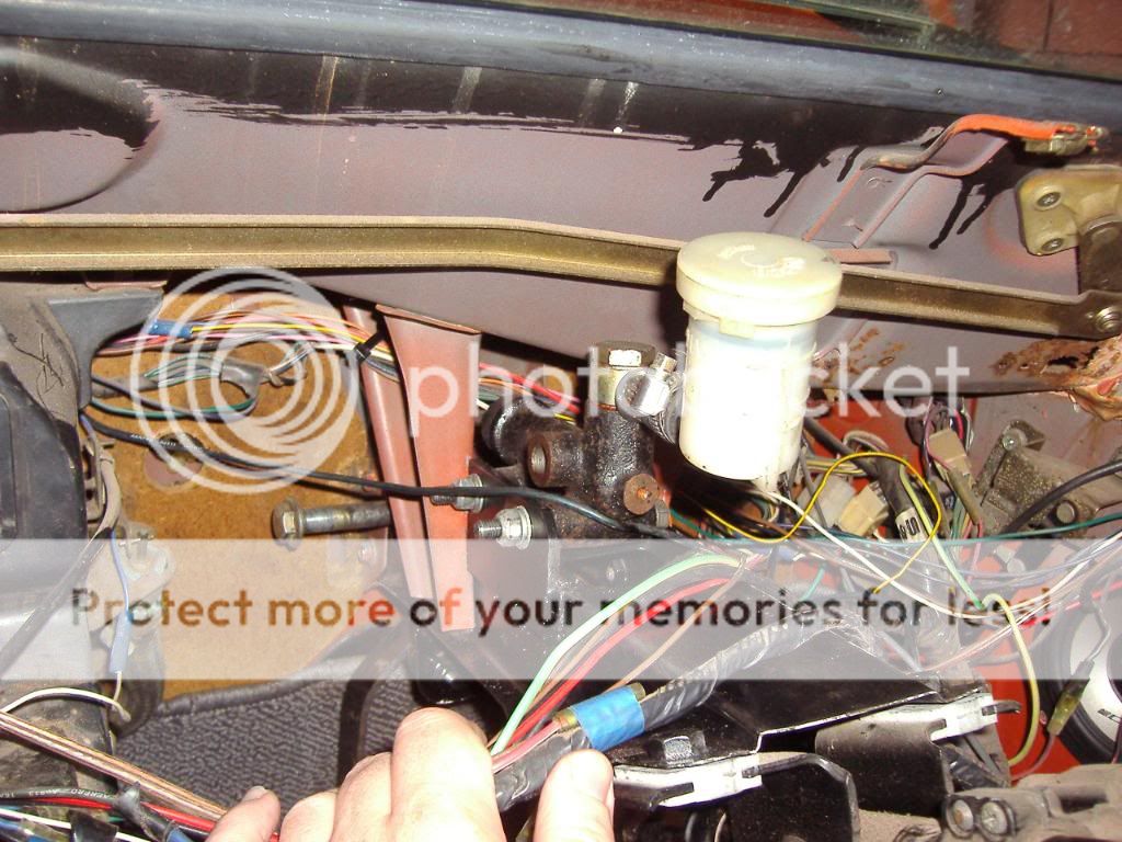

Built one with Z18 and Built some with 4AGE,for the clutch use a formula car master cylinder mount it on top of the steering column support,simply line the clevis pin of the master cylinder up with where the original cable hooks on to the standard clutch pedal then bolt it up.
Use a remote reservoir and run the lines thru the firewall to the master cylinder and make sure to use the right spec hose for the job.
Custom headers required I sand bent 4>1 system 35mm primaries 39 inches long and a proper merge collector with central diamond on a 4AGE it will make good torque and will rev cleanly to 8600 RPM making power all the way to redline with some other tweaks.
Custom fabed engine mounts as well other than the normal wiring or aftermarket ECU all too easy.
Forgot to mention the pull cable pushes the master cylinder which is fitted back to front with the clevis pin section facing forward,super neat and sano way to go and really easy when you look at it

clutch on steering column... do this or buy maddat kit
