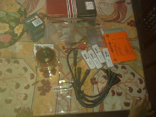

Just Bought Brand New Ignition Coil,Plug wire Set ,Ignition Condenser,Spark Plugs ,Carburetor Repair Kit,rotor etc needed for the engine.
thanks
regards
sumith
