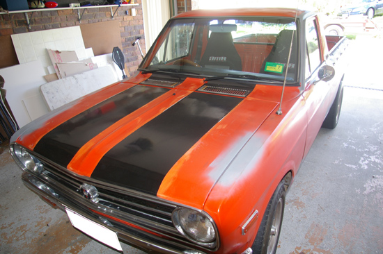

A few months ago I read a forum on how to paint your car with a roller and foam brush. For me I thought this would be a novel idea since I don't own a paint gun or compressor and I can't really spray in my garage anyways since I don't own it. I started by testing out some black stripes which I had always planned to do ever since another member tried them out on his green coupe. So I bought a roller and some thinner and made a super thin wash of gloss black and layered up about five coats on the hood. It was more a test than anything but the stripes stuck because they added about 10 hp to my ute. At least the hoons here around the Gold Coast think so because I've had a a ford hatchback, a black supra turbo, and some dodgy white van all try to race me on separate occasions when stopped at a light since the stripes went on. I don't participate in that by the way. With the hatchback I pretended like I was going to race them when the light turned green, but I didn't move on purpose and sat there watching them fishtail across the intersection very stupidly.
