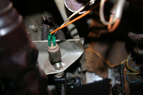

but more likely the plastic piece that actually pushes it (part of brake pedal) has perished, these are often replaced with a bolt and nut on the ol' dattos these days

I had a look at the brake pedal where the switch is located and fitted a nut and bolt there (as suggested) since there was an empty circular hole where the switch fits in to, as you guys guessed correctly. (see the red arrow) I'm thinking that mashing the pedal the other night broke away whatever was there before. So the brake lights work properly again! Hooray!
Does it matter where each of the two green wire ends go on the switch? It seems to work either way and I didn't label them before I took it off.

wire connection orientation doesn't matter
