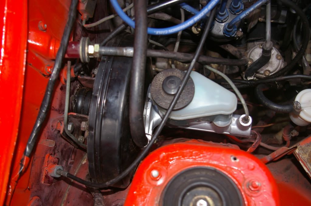

What work is required to get the brakes back to the normal setup? Is it simple? They are disk brakes on the front from a 120Y and standard drum brakes on the rear. Cheers.
Compared my engine bay to a friend's 78 Corrolla and the boosters were different
As requested here are some photos of the my UBB (Unidentified Brake Booster):

DISCO_BOB Posted on: 2011/8/22 13:06
jeff looks like a corolla ae101/ae111 (ish) booster and master 98-01(ish).check booster book at repco/bursons/etc. i may have one under the house, i'll reply if i have one.

datsunbeginner Posted on: 2011/8/22 13:22
Awesome. Thanks Jamie.
